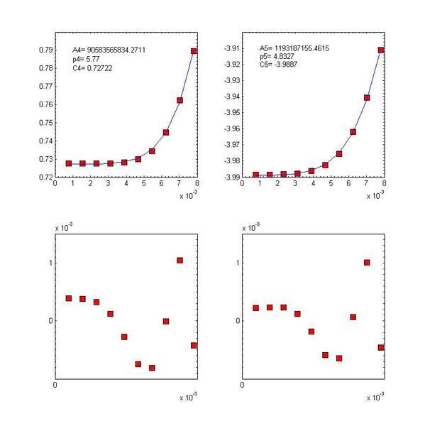

I've managed to fit a really nice curve to my data. Plotting the residuals, I see that there is structure that's unaccounted for in my model, but the residuals are very small, so it does provide an accurate 'rule of thumb'.
The curve fits better than what I obtained using a log-log plot with linear regression, but when I subtract the intercept obtained using nonlinear regression and then plot log-log, the data does not look linear, and the fitted line completely misses that first few points. This is because the log-log plot exagerates errors in the small values, and suppresses them in the high values.
I find this interesting because it brings into question some of the previous work I've done where the data went through the origin and I quite happily used linear regression on a log-log plot. Still, this it the standard way these sort of problems are expected to be tackled, and all data is generally presented in a linearised form if possible. I just don't think it's that good if it causes the RMS error in the fitted curve to be higher than it would be if the data wasn't linearised in the first place and if non-linear regression is used instead of linear.

What do the residuals looks like? Be very weary of non-normality or changing variance; it can completely destroy the credibility of your estimators. When in doubt, run a robust regression model and see if the estimates are consistent.
The two data sets are shown as red squares in the upper two plots, with the fitted curves shown in blue. The residuals are shown for each data point under each respective plot. Note the 10^-3 on the y-axis for the residuals.
For actually finding a model that explains the data, this might not be the best fit, but that might not matter. The purpose of these curves is to motivate the choice of certain experimental parameters in order to minimise error in a particular experiment. There is no real reason to try to extrapolate these data, and given a value between 0 and 8 x10-3, one can quite reliably choose a value for these two parameters.

If you're not doing any inference and are just trying to "see what the curve looks like", then you should be fine. It looks to me like the error variance is increasing quadratically-ish; if you wanted to be rigorous, you might try fitting a weighted least squares model.
I might have to do some reading as I don't know much about this subject, but yes, for my current purposes I think what I've done will suffice.

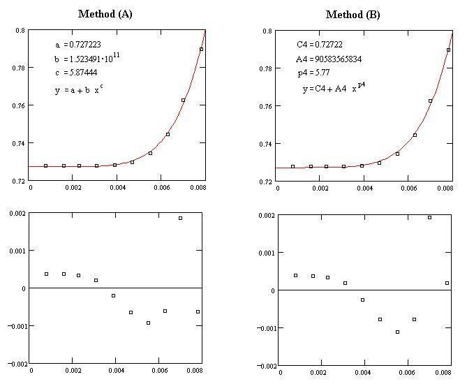

Hello ballzac,
I have tested the power law y=a+b(X^c) with your data and observed that the fit is rather good.
I used data coming from your graph (post #12) which is not accurate enough. It should be better if you pubished the data on numerical form instead of on a graph.

Thank you for having published the input data.
I agree that the results should be exactly the same if the criteria for optimization where the same, which is far to be the case.
I compare the results in the two cases (A) and (B), as shown on the joint figure.
Case (B) : with the values A4, C4 and p4 given in your post Nov7-11 10:17 PM.
Probably, the criterium for optimization was the minimal mean square deviations. Since the equation is non linear relatively to the parameters to be optimized, the process is probably recussive with guessed starting values.
Case (A) : The method used is referenced in post Nov7-11 06:37 PM. As explained, the criteria is completely different, since the goal is to process without recurence and without starting guess values. Of course, the mean square deviation is expected to be not so good than with method (B). On the other hand, the computer program is very simple to write and, more important, the number of operations during the computation is much lower, which is an advantage in case of big imput data (no advantage in the present case of only 10 points).
I was interested to see if the methods (A) and (B) lead to close results for the given example, even if the small number of points is not favourable for method(A).

Hey, thanks for all the effort you've gone to.
For the purposes of having a heuristic model, I think both of them are 'pretty good' fits. In fact, the uncertainty in those figures is roughly plus or minus the last decimal place (except for the x values which are 1,2,3 etc. divided by 1280 exactly) and it's possible, though I haven't checked yet, that both models would go through every point, within the uncertainties. As far as actually determining the 'real' formula, I really need to work out what it should be analytically, and then decide if these models are consistent with the analytical result, within the uncertainties.
