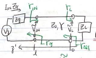

Turkey in the oven and I have a little time!
Let's consider a standard tx line model with R' series with L' and then with the shunt capacitance C' parallel with conductance G'. where all are values per unit length. Using solution of differential equation of the voltage and current phasor, we agreed on
[tex]Z_0=\sqrt {\frac {R'+j\omega L'}{G'+j\omega C'}}\;\hbox { and we define } \delta = \alpha + j\beta\;=\; \sqrt{(R'+j\omega L')(G'+j\omega C')}\;\Rightarrow Z_0=\frac {R'+j\omega L'} \delta[/tex]
[tex]\delta = \alpha + j\beta\;=\; \sqrt{(R'+j\omega L')(G'+j\omega C')}\;=\; j\omega\sqrt{L'C'}\sqrt{1+\frac{R'}{j\omega L'}}\sqrt{1+\frac {G'}{j\omega C'}}≈j\omega\sqrt{L'C'}\left(1+\frac{R'}{2j\omega L'}\right)\left(1+\frac{G'}{2j\omega C'}\right)\;\hbox { using binomial approx for low loss.}[/tex]
Expand this out, you'll get:
[tex]\delta ≈ j\omega\sqrt{L'C'}\left[1+\frac 1 {2j\omega}\left(\frac {R'}{L'}+\frac{G'}{C'}\right)\right]\;\Rightarrow \alpha =\frac 1 2 \left(R'\sqrt{\frac {C'}{L'}}+G'\sqrt{\frac {L'}{C'}}\right) \;\hbox { and }\;\beta=\omega\sqrt{L'C'}[/tex]
[tex]\hbox { velocity =}v_p=\frac {\omega}{\beta}\;\hbox{ therefore it is independent to R' and G'.}[/tex]
[tex]Z_0=R_0+jX_0 =\frac {R'+j\omega L'} {\delta}≈\sqrt{\frac {L'}{C'}}\left[1+\frac 1 {2j\omega} \left( \frac {R'}{L'}+\frac {G'}{C'}\right) -\frac {R'G'}{4\omega^2L'C'}\right][/tex]
[tex]\hbox {For low loss, R'G'<< }4\omega^2L'C' \; \Rightarrow \; R_0≈ \frac{L'}{C'} \hbox { and } \;X_0=-\sqrt{\frac{L'}{C'}}\frac 1 {2\omega}\left( \frac {R'}{L'}+\frac {G'}{C'}\right) ≈0[/tex]
Therefore the characteristic change very little for low loss tx line. We usually don't use high loss tx lines! Excuse me if there is any typo, turkey is calling me, so......
For the op, this might be the place to start.

I am reviewing my notes, just to confirm, I just have to give you a system of a signal generator driving into your DUT( tx line) and the output of the DUT( the other end of the tx line) drive into the antenna.
I just looked up the insertion loss [itex]IL=20Log\left( \frac {V_T}{V_R}\right)\;\hbox { where } V_T ,\;V_R\;[/itex] are just voltage at the load when generator connected to antenna directly and generator to tx line then to antenna respectively.
Confirm this while I read up my notes and hopefully I can give you the equations so you can write the program. It is done in phasor and I hope you understand those...at least to write in programs that consist of complex exponential functions.
We'll see what happen.

148053[/ATTACH]"]
It is very important to be clear about where is the reference. In this case I follow the SMITH CHART convention where the LOAD( antenna) at [itex]z'=0\;[/itex]. The length towards the generator is [itex]z'>0[/itex]. It is very important to be clear about this as different textbook use different definition and the formulas will be different.
Read back post #20 for the other definitions. I denote generator components using suffix g, and antenna as the load using suffix L. First [itex]\Gamma\;[/itex] is the reflection coeficience and is defined as:
[tex]\Gamma_g=\frac{Z_g-Z_0}{Z_g+Z_0}\;,\;\Gamma_L=\frac{Z_L-Z_0}{Z_L+Z_0}\;,\;\Gamma_{IN}=\frac{Z_{IN}-Z_0}{Z_{IN}+Z_0}\;,\;\Gamma_{OUT}=\frac{Z_{OUT}-Z_0}{Z_{OUT}+Z_0}[/tex]
Where [itex]Z_g\;,\; Z_L\;,\;Z_0\;[/itex] can be complex. [itex]\;Z_0\;[/itex] is usually real. You don't choose a tx line that has complex impedance to make your life miserable! Usually people design so even [itex]Z_g\;,\; Z_L\;[/itex] are real right at the frequency of operation. You'll see if those are real numbers, it can get quite easy.
Hey moderator, please check my work as I don't even trust myelf!
I equate [itex]V^+_0\;[/itex] in term of the generator voltage [itex]V_g\;[/itex] so it is easier to cancel out later:
[tex]V^+_0=\frac{V_g e^{\delta l}(1-\Gamma_g)}{2(1-\Gamma_g\Gamma_Le^{-2\delta l})} \;\hbox { and }\;V_L= V^+_0+V^-_0=V^+_0(1+\Gamma_L)=\frac{V_g e^{\delta l}}{2} \frac{(1-\Gamma_g)(1-\Gamma_L)}{(1-\Gamma_g\Gamma_L e^{-2\delta l})}[/tex]
[tex]IL\;\hbox { is insertion loss and }\;IL=10 log \left[\frac {|V_T|^2}{|V_R|^2}\right]\;\hbox { where } V_T= V_L\;\hbox { when }l=0\;\;,\;\;V_R=V_L \hbox { when with tx line length } \;l[/tex]
[tex]\Rightarrow\; V_R=\frac{V_g e^{\delta l}}{2} \frac{(1-\Gamma_g)(1-\Gamma_L)}{(1-\Gamma_g\Gamma_L e^{-2\delta l})}\;\hbox { and }\;V_T=\frac{V_g}{2} \frac{(1-\Gamma_g)(1-\Gamma_L)}{(1-\Gamma_g\Gamma_L)}[/tex]
[tex]|V_T|^2=(V_T)(V_T^*) \;\hbox { where }\;V_T^* \;\hbox { is the complex conjugate of }\;V_T. \;\hbox { and }\;|V_R|^2=(V_R)(V_R^*)[/tex]
Look at this first and see whether you can understand this. You have to try to get the last part to get the amplitude and it can get tedious. But this is basic complex number calculation and you should know this.
Attached is my notes that give more of the derivations.
