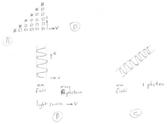

I have attached a document. Correct me what is wrong.
You see in A (a moving light source and many photons), with building light waves (vertically), so an em field like in B.
Do you tell me that on the hypotenusa also an em field is building, with a real light wave and light speed (so not an illusion) ?
And if yes, why is the horizontally line in D no em field ?
Am I right when I think em fields can have constant speeds like V (and other speeds), or is it the light source which can have a constant speed (and other speeds) and the em field is just following ?

I am not sure what you are trying to describe with these drawings. If I am understanding the scenario correctly then I don't think that there is a device which can generate what you have drawn. Let me ask some questions about your intention.
Does the source produce collimated light like a laser or non collimated light like a light bulb? If collimated what is the direction?
Is the source producing light across a small aperture (approximately like a point) or across a large aperture (approximately like a line or plane)?
Is the light coherent with some particular phase relationship or incoherent?
Is the light pulsed or continuous?

I forgot to tell that C in my drawing belongs to the hypotenusa (my dictionary does not work anymore on Windows 7, so that's een problem in translations sometimes but I go the buy an update soon).
My drawings is the situation as Jaspers light .. so the hypotenusa in my drawings is the path of Japsers light ... and the light wave moving with speed V to right .. the many photons are part fom that moving light wave ..
I am very very curious, because I learn than a lot with one answer from you, how I must see this situation with em fields (so light) ...

OK, so the light is collimated along an axis perpendicular to the axis of relative motion in the source's rest frame, it uses a small aperture, coherence doesn't matter, and it is pulsed.
Then, regarding your preceeding questions:
Yes.
I don't know what line you are referring to.
The EM wave will have a constant speed of c, regardless of the speed of the light source. That is the second postulate of relativity and is confirmed by lots of experimental evidence.

It was the horizontally line on the level of the moving light source, D in my drawings.
The light source is pulsed, so that is not an EM field.

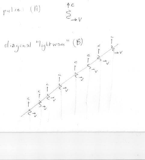

3) Exiciting to know how I must see this situation. I attached again a beautiful drawing.
See A. So I guess a pulse is a short lightwave (in fact maybe it answers partially questions 1/2), it has a speed C up and a sideways speed V (so keeps this speed after the em field is switched off) and bouncing between the mirrors.
See B. The pulse forms the diagonal light wave (or line) with his vertically short lightwave ? Why has the pulse on the diagonal line, speed C in the diagonal direction ( we can not speak about a light wave in the diagonal direction, because the short light wave is vertically) ?

Your questions about numbers of waves are very confusing. As I already told you I don't know what it means and I don't know how you would count numbers of waves. Unless you can explain in detail what you mean there is no point in continuing to ask me about it.
The speed of a light wave is c. Speed is the magnitude of velocity by definition, not a component. So if you have a light wave with a horizontal component of velocity vx then the vertical component vy is given by
[tex]\sqrt{v_x^2+v_y^2}=c[/tex]
You cannot get a component c up and a component v to the right because the speed would be greater than c.

For simplifying things, I work in mind (so with thought experiments) with only 1 light wave.
So my last drawing shows a vertically short light wave (Zoe's pulse).
Now I understand you say, because of the horizontal Vx component in Jasper's frame (was 0 in Zoe's frame) that's light wave direction is the diagonal line. Now I understand that a light wave's direction can be changed (or seen) as just for other objects (like a basket ball in Zoe's and Jasper's frames).
The diagonal line has a short light wave now, moving over that line with speed C.
Wihout knowing that a light wave's direction can be calculated in this way, you could not understand this example. Now I really understand .. thanks very much ..
But there is a difference, if a piramide object with his top above is moving up and down in Zoe's frame, the top will still be there in the same position in Jasper's frame only the moving direction of the piramide object is different. What is the difference with light ?
Yes, the difference being that the speed of a basket ball is not frame-invariant.

DaleSpam said:
I don't understand the question. What does the shape of the object have to do with anything? If it is light it moves at c and if it is matter it moves at some v<c. The shape is not important.
That's also interesting for me that you don't understand that.
If you look to my last drawing, you can interpret the speed C on the diagonal line in 2 ways, the difference is very important for the result (I think).
The shape is very important now because that's the direction of the light wave. If the light wave's direction is not rotating like a compass needle (under pressure of own formulas), you can have 1) a component up = C or 2) the speed on the diagonal line = C (if ever real meassured like in this situation, that's different than meassuring the speed C in Zoe's frame where the light source is/was). If the speed is C on the diagonal line and the direction of the light wave is up, than the Vy component is < C (direction light wave). What is true (and really proved) ?
Besides normally you may not compare two frames in 1 view, and we do that now mathematically .. normally we work with clocks etc. to see it in 1 view and now it goes so easily (for my feelings strange, the chicken and the egg) ...
digi99 said:
What you say about the transform is interesting because I did such transform also in another topic. But I thought it's only possible for the line light itselves, which other objects it is not possible. I thought you can use Lorenz only to see from the moving object itselves (standing still) how time and distances are. But is it also possible with a Lorenz transform that you have something moving X and a movement B in a rest frame A, and that you can transform moving X in a rest frame of B (by using the transformation for coordinates) ?
You can use the Lorentz transform to change coordinates for any object or path. It is not limited to light nor to paths of objects which are stationary in one of the frames.
1) is wrong. 2) is correct.

Thanks DaleSpam for all the answers, I go to play with Lorenz the coming days/weeks (when I have time, it's an interesting subject) and to look carefully to its derivation because I want to understand the basics very well before to continue to next subjects in relativity.
Ok the postulate of Einstein says, the speed is always C but the light wave's direction is not really involved.
Maybe is it unlikely that the direction of a light wave is different than it's velocity direction, but it can be a leak if V > C will be proved maybe in the future by more experiments (something must be wrong in that case).
I let you know what I think for myselves after a while in this topic (maybe I fully agree with you, maybe not, who knows the real truth ..).
I was trying with only a Lorenz transformation to find a function for the diagonal line, but that's difficult.
1) Can somebody shows with Lorenz that the velocity direction of the short/long lightwave is the diagonal line and the lightspeed is C on that line ?
2) If you look to the Lorenz derivation (transformation coordinates) only the speed of light (velocity direction) is involved and not the direction of the light wave itselves. This could mean in fact that speed (velocity component) of the light wave in its direction can be lower C if in a situation speed is C in it's velocity direction. This could be an error leading to another formula in the future (when V could be greater C possibly).
Can somebody proove (or is it proved), that the velocity direction is the same as the light wave direction ?
The easiest way to do this is using 4-vectors: [itex](t,x,y,z)[/itex] with units such that c=1.
For a pulse of light along the y-axis from the origin the world line is [itex](t,0,t,0)[/itex]. Boosting this to a primed reference frame in the standard configuration moving at velocity v gives. [tex]\left(<br /> \begin{array}{cccc}<br /> \frac{1}{\sqrt{1-v^2}} & -\frac{v}{\sqrt{1-v^2}} & 0 & 0 \\<br /> -\frac{v}{\sqrt{1-v^2}} & \frac{1}{\sqrt{1-v^2}} & 0 & 0 \\<br /> 0 & 0 & 1 & 0 \\<br /> 0 & 0 & 0 & 1<br /> \end{array}<br /> \right) \cdot \left(<br /> \begin{array}{c}<br /> t \\<br /> 0 \\<br /> t \\<br /> 0<br /> \end{array}<br /> \right) = \left(<br /> \begin{array}{c}<br /> \frac{t}{\sqrt{1-v^2}} \\<br /> -\frac{t v}{\sqrt{1-v^2}} \\<br /> t \\<br /> 0<br /> \end{array}<br /> \right) = \left(<br /> \begin{array}{c}<br /> t' \\<br /> -t' v \\<br /> t' \sqrt{1-v^2} \\<br /> 0<br /> \end{array}<br /> \right)[/tex]
It can be proved that Maxwell's equations are invariant under the Lorentz transform. So however light behaves in one frame, it behaves according to the exact same rules in any frame. The behavior wrt "velocity direction" and "wave direction" is determined by Maxwell's equations.
http://www.mathpages.com/rr/s2-02/2-02.htm
Thanks DaleSpam for this answer, I understand (the math is the solution some Lorentz equations in some directions, the result I understand).
Ok so by Maxwell is velocity direction always wave direction (I will believe this).
