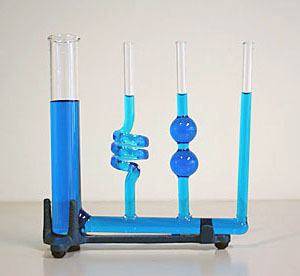

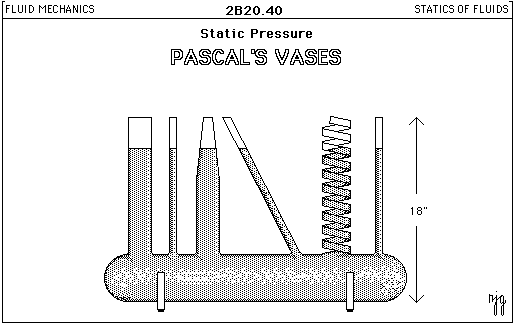

Pascal's vases:
Another set:
Notice that no matter how weird the shape, the tops of the liquid surfaces in the different containers are at the same level. The pressure difference in some container from bottom to top does not depend on shape. It depends only the height of the liquid.

The diagram and image (real) I posted in [post=3643843]post #16[/post] are pretty solid evidence. Hydraulic pumps rely on this principle.
