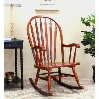

I have had a rocking chair in my basement for 20 years gifted to my by my father that I've never been able to repair.
Its top-back rail has split and is in just the wrong place to mend. I'd like to wrap it in leather or sinew then let it dry and shrink to hold fast. Problem is, the central spine is right where the split is. It's this kind:
...but the central pillar is about 3" wide. It's split at the chair's highest point.
I'll take a pic and post it.

You might want to get a piece of steel rod 1/8 inch diameter (1/4 maybe) about 6 to 8 inch long, recess the rail to put the rod in, curve the rod, glue it, put wood splinter in the recess, venneer,...
Taper the ends of the rod to eliminate a stress comcentration.
Use instead of steel, a less rigid metal or fiberglass or graphite or another tough wood, and change the diameter or shape to suit the application - flat, square, round,
Make sure you have some way to secure the rod to each piece of the rail so the rail does not separate after repair - re-repairing will become exponentially more difficult.

If you can stand the appearance, wrapping the split in wet rawhide is actually a good choice. I mended a large crock for brewing beer using wet moose-hide. It was badly cracked, so I painted the cracks with epoxy and bound the crock with moose-hide. It served me well for many years.

This would be fine. I've no problem with seeing the exposed rawhide Unfortunately, though I can wrap the split in rawhide OK, I would then have to cut it open lengthwise in order to make way for the central spine slotting in.

Dave, if you want to give it your best shot, here's what I'd try...
1) open that crack so you can get epoxy into it.
2) get epoxy into as much of the crack as you can.
3) bind that repair with wet rawhide as tightly as you can, so that it tightens up when shrinking.
4) be prepared to scrape/sand/refinish the wood after taking off the leather.
