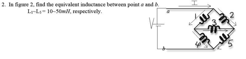

Assume we have Vab.
Junction Rule:
I1 = I3 + I4 => I'1 = I'3 + I'4
I5 = I2 + I3 => I'5 = I'2 + I'3
Loop Rule:
V - L1I'1 - L4I'4 = 0
-L1I'1 - L3I'3 + L2I'2 = 0
V - L1I'1 - L3I'3 - L5I'5 = 0
V - L2I'2 - L5I'5 = 0
First I tried 2 junction equations and 3 loops without V. Then I eliminated to the last 2 equations with 2 unknown, but I got 2 same equations.
Now I try with the equations above and still got 2 same equations.
I'm thinking maybe it's not write to say that I1 = I3 + I4 => I'1 = I'3 + I'4.
I need some suggestions about what loop should I use.

ε=Leq[1/[(1/di1)+(1/di2)]]
