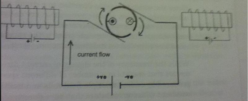

1. Small electric motors with only one armature loop sometimes get stuck. They can be started again by giving the armature a small twist. Looking at the diagram below, what might be the explanation for the motor not being able to start on its own?
When the brush(es) reaches the split within the ring, current ceases to flow. This lack of electricty will stop the split ring commutator and evidently, the motor. Since no current can be transmitted, the motor can't start on its own. However, giving the armature a small twist will close the circuit allowing the motor to operate.

Your answer is fine. Can you think of some things that could be done to minimize this problem with DC brushed motors?
The problem can be minimize by using more than one armature
Good answer! :smile:
