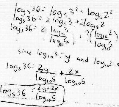

seiferseph
102
if log2 = x and log3 = y, solve for log(base5)36 in terms of x and y.
how do i even get started on this? I'm really confused with logs.

thanks, but I'm not sure if that is correct (the teacher actually said it was quite simple). the last question was something like a^2 + b^2 for the answer. i'll post a little bit of what i got, I'm not sure if this is right
Do you realize that your original question is about log_5(10), but the handwritten thing you posted now is about log_5(36)?
now i do :blushing: its supposed to be log_5(36)
