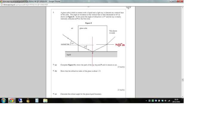

Part A i just need to know if i have done it properly.
Part B is done
Part c don't have a clue :cry:
Law of refraction n1*sinχ1=n2*sinχ2
Critical Angle sine(x) = nr/ni
part a is on the image above
part b I have done it
Part c no idea
Read the wording of the question very carefully...the ray is totally internally reflected at P for the first time...
This means that the ray is striking the surface at the critical angle... can you see which angle is the critical angle??
Part A All OK.
Part B apply snells law you have all the info!
Part C I have looked at the question paper on the the AQA website and part c is worth 1mark! This means no formula are needed!
The important line is "At this point the angle of relfection is 27 and the ray is totally internally reflected for the first time."

The important line is "At this point the angle of reflection is 27 and the ray is totally internally reflected for the first time."
And technician directly addressed that issue.
Another way to look at this is that the critical angle is angle of incidence for which the angle of refraction would be 90° .
I hope that helps.
Thanks guys I just reliased I was being stupid. I was taking the angle of incident for the critical angle to be 27° instead of taking it from the normal. Thanks for the help:-p
