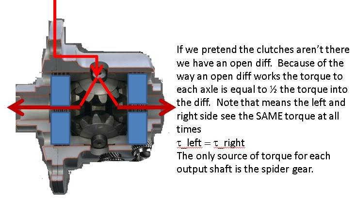

Yes; because of the way open diffs are constructed, the torque to each wheel will always be the same, and because of the difference in distanced traveled by each wheel, the power delivered will be different.
This also applies to slip conditions.

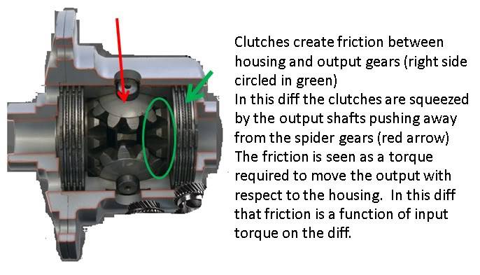

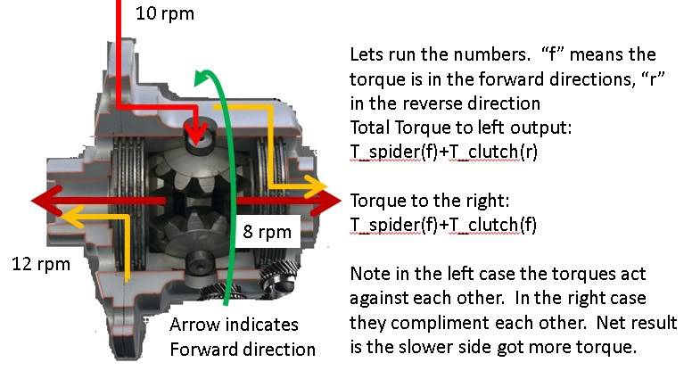

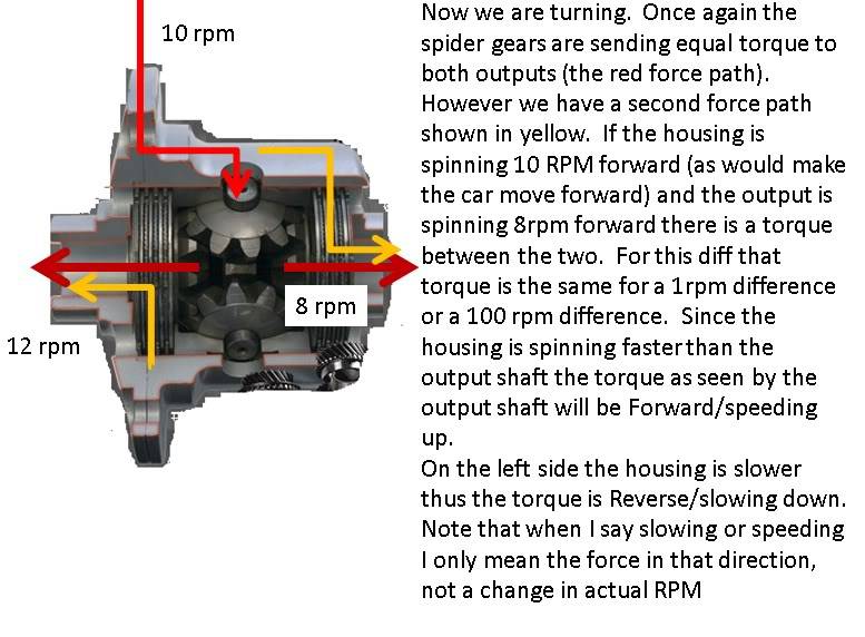

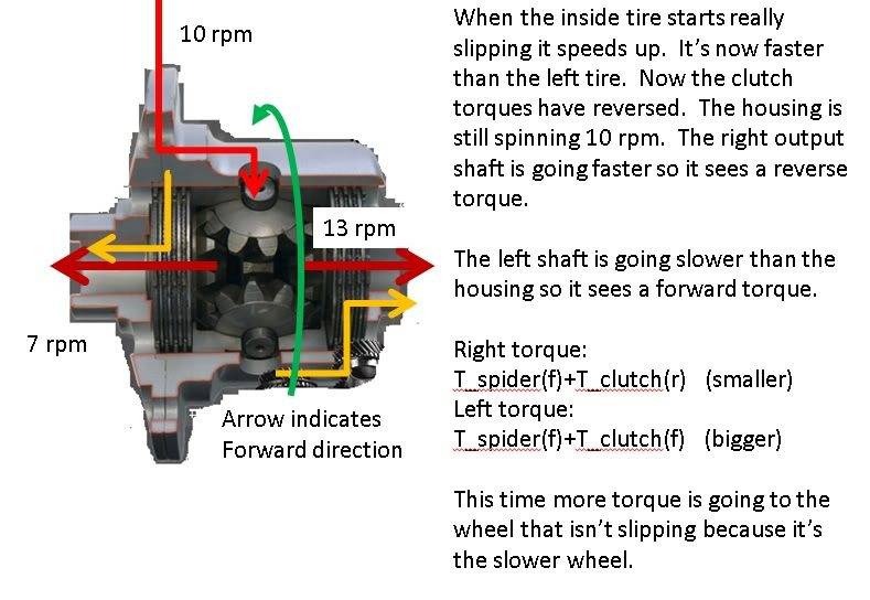

Jan4-12, 08:55 PM   #15
Not quite; in fact there is a small tendency to drive the slower tire more than the faster one because of the friction of the differential gears themselves, but I'm being pedantic.
1. An open diff drives both wheels all the time with the same torque whether in a straight line or cornering. Trying to accelerate with the inside tire on ice and the outside tire on pavement should prove to you that an open diff doesn't allow either tire to "coast".
2. An LSD typically uses clutch packs to resist different tire speeds with no preference to which tire is going slower or faster. Usually there is a break-away torque that is preset with spring pressure. Drive torque (stepping on the throttle) increases the break-away torque value by forcing the spider gears apart, putting more pressure on the clutch packs.
3. A Detroit style locker is the only diff that coasts or overruns on the inside tire. It has a ratcheting mechanism to allow that.
4. A spool is locked 100% of the time and is the one that causes the chirping.
