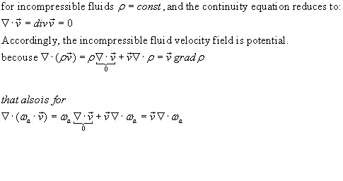

I'm trying to understand why the del operator is working a certain way.
So in my literature there is a term:
[itex]\nabla \cdot \rho_a \mathbf{v}[/itex]
but then after saying that
[itex]\rho_a=w_a\rho[/itex]
the term can somehow become
[itex]\rho (\mathbf{v}\cdot \nabla w_a)[/itex]
I do not understand how nabla and the velocity, v, get flipped.. Is there some assumption that needs to be made for this to be true?

It's literature on fluid dynamics and chemical reactions. The equation I am looking at gives
[itex]\frac{\partial \rho_a}{\partial t}+(\nabla \cdot \rho_a \mathbf{v})=0[/itex]
and then after defining that rho_a=rho*w_a they rearrange the equation to give
[itex]\rho \left ( \frac{\partial w_a}{\partial t} + \mathbf{v}\cdot \nabla w_a\right )=0[/itex]
so rho is a density, t is time, w is a mass fraction, and v is velocity.
I'm just not understanding what rule you follow, if any, to flip [itex]\nabla \cdot <br /> \mathbf{v}[/itex] without it meaning something completely different.
Does this make sense?
here is something in attachment

Thanks I think my misunderstanding is resolved. They are the same because in the product rule the divergence term drops when incompressibility is assumed. Thank you.
