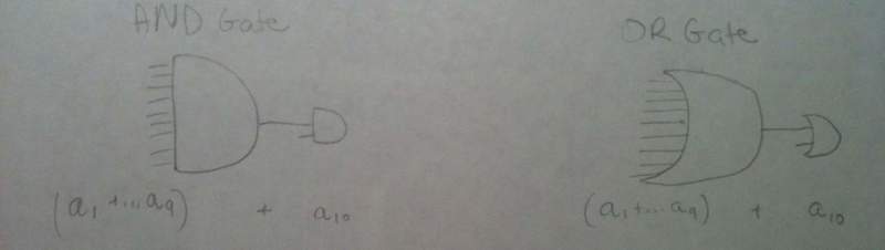

In the Xilinx software symbol library (student edition version 10.1), the maximum number of inputs for AND and OR gates is 9. What would you do if a 10-input AND and OR gates are needed? Draw the schematic diagrams and show the connections.
(a1+a2+...+a10)=(a1+a2+...+a9) +a10
Boolean Equations:
AND: multiply each input = output
OR: add each input = output
Put the AND operations to 9 AND input and then pass the output to the two inputs with another input as a10.
Similar thing can be done to OR gates.I have attached my attempt sketch. It looks like I have 11 inputs in total and I need 10. How can I sketch the connections of the 10-input gates?
Xilinx ISE has a notation for something we might call a "bus". It is a name follow by an interval specifier. See the example below.
http://uhaweb.hartford.edu/jmhill/suppnotes/isetut/ise9x2/schem_fourbit_2.png
So you could label each dangling wire, and then connect all ten wires together to a bus named "a(9:0)" just as the bus "Avail(3:0)" picture above.

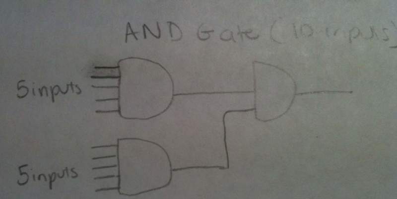

I think I need to take two 5-input AND gates and connect the 10-inputs. Then take 1 2-input AND gate and connect output of two gates to the input of gate. Will the whole system function as a 10 input AND gate?
How do I represent that? I've attached my attempt
