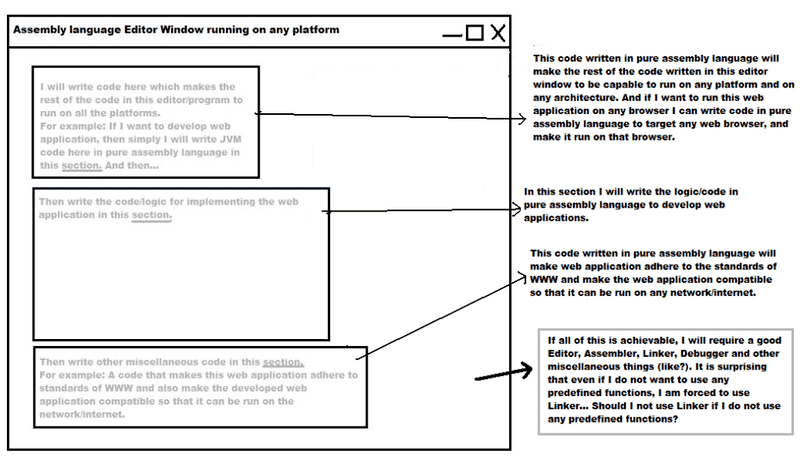

Hello everyone.
I have lot of extra time. So, I thought why don't I do some pure assembly language programming. So, basically, first I want to target 80x86 architecture processor. And get solid idea and understanding on programming through pure Assembly language. I don't want to learn assembly language in a way which will make me use pre-defined functions later. I mean, I want to write all of the code in pure assembly language, as if I am creating a new Operating System. I have learned somewhere that no Operating system gives any random user a privilege to interact with the HDD and other critical components of a computer and if random user wants to access any of those critical components, he/she is suppose to take help of pre-defined functions described by the Operating system. I believe, by taking use of these predefined functions, the user will be confined to do the usual things that Operating System will allow you to do. If someone needs extra control over the system, he/she must reverse engineer the entire targeted Operating System and figure out everything and then exploit the flaws and gain access to the critical components. I don't want to go into doing exploitation business. I want to learn genuinely and just for fun. I don't have any big goals. But I want to learn pure assembly language seriously.
Objectives:
1. Just for instance: If I want to draw a curve on my display console I must be able to this through pure assembly language. I don't want to take help of any pre-defined functions. I mean I want to interact with the three color guns (Red,Blue,Green) of CRT monitor directly and be able to draw my desired curves.
2. I want to learn the assembly language such that if someone gives me any processor of any architecture and whether it is 8 bit, 16 bit, 32 bit, 64 bit, 128 bit ... or any custom built multi-core microprocessor with 17 bits or 19 bits and an added extra register segment and additional control unit segment inside this custom built microprocessor with other components and peripherals as well, I must be able to look at the manual and must be able to implement my logic. Logic which even includes writing the entire Operating System and/or Graphical User interface through pure assembly language.
I know, this is going to be very very very hard for me who just knows the basics of a particular processor and about it's architecture. And I am certainly not a master at it. But, as I said earlier, I don't have any big goals just looking to pass my immense amount of free time by doing some pure assembly language programming. Please help.
So, I require:
1. A good assembler which, should I say, meets my requirement (please read further to know more about the requirement and will help you get an idea). I know there are assemblers like FASM, MASM, NASM, TASM. I think, I used NASM earlier. I don't know if it supports any predefined functions. But I don't want to use any predefine functions as I described my intentions earlier. So, help me in selecting the best assembler that could be nice for me and which don't support any predefined functions and will enable me to write pure assembly language code.
Also, I want to do my pure assembly programming without interacting with installed Operating System as if I am in 1960s - 1980s and where all I have is DOS. And I am trying to develop a revolutionary Operating System from scratch. So, that after I develop this Operating System, which even includes support(device drivers) for monitor and other peripherals, I want to burn this code into another machine's HDD(generally create .ISO image file, I guess) and get the machine work using my developed Operating System. Tell me if that is possible today.
2. Editor window. I don't remember what editor window I used earlier. So, I need your help here also.
I also want to say that, I am serious in learning pure assembly language as much as I could. Maybe, if I find it not very very complex I might go ahead and think about developing device drivers or an Operating System or Graphical User Interface through pure assembly language, in a way where I don't have to use any predefined functions. I think, I have already stressed a lot on learning pure assembly language.
In addition to all the above that I have said, which is the main objectives and goals and aims. I also want to say the following, so that it gives you some idea, I want to get the ground knowledge of using pure assembly language and experience the era when there was only DOS and how people felt happy when they first created games using pure assembly language and when sounds devices were included with the computers, those people learned to put sounds in their games through pure assembly language. I think this paragraph will give you an idea about what I am looking for. I don't care how efficient or fast or execution or assembling of pure assembly language will be, unless we had different versions of same type of assemblers in those days. I don't want to talk more details on this. But I think you certainly have an idea by now about my requirements. I only want to learn pure assembly language. All the above may look very lofty ambitions but this is just for fun and I am serious in learning pure assembly language.
Thanks.

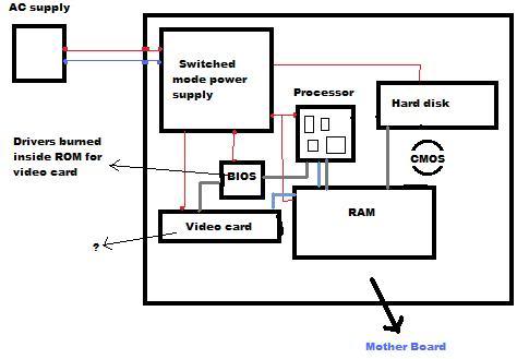

Okay. I want to try the following. Tell me if it's possible. First, I want to buy a single core processor, video card, basic RAM, HDD, Processor compatible Motherboard, keyboard, a mouse, CRT Monitor, HDD cables, CMOS battery, and I guess, internally, all the components in the computer system runs on Switched-mode Power supply, so, I would want to buy that too. And now I am thinking about connecting all of these component together. Please guide me if I am missing any component here. So, if everything is right here. I have my home-assembled computer ready. Now, if I switch on my home assembled computer, I will not see anything on my monitor because there is no System Software. So, now I am thinking about making my own System software. Even writing the interface which helps me edit the settings of the hardware. I mean, the interface which we get when we press DEL during boot time.
Tell me if I understood this correctly:
As you pointed out manufacturers of video card do not provide their interface and I am suppose to use their functions, and make function calls to display text or to display graphics on my CRT monitor by making use of BIOS(drivers that are already burned inside the ROM). The BIOS is connected to video card. So, that means, I have to call the function from BIOS code. And once the control is in graphics mode, I can directly write to a portion of graphical memory and display graphics but I have to switch between banks of video card to display text message on my CRT monitor.
Do you think I definitely need to include video card in my set up? I mean, I am not going to write any intense game logic. And should I definitely include a video card? I thought there is always a built-in circuitry inside the CRT monitor. And this built-in circuitry inside the CRT monitor will have registers and some processor or perhaps a micro controller, attached to color guns(Red,Blue,Green). And I could just use pure Assembly language to target those chips on the mother board as well as inside the CRT monitor. I don't want to learn about the interface that these video card manufacturers provide if you say that I don't need video card just to display few 2-D lines and curves on my CRT monitor. Is this interface, that you mentioned, does it have specifications of how the electronic circuitry of video card is built?
If you have ever seen Matlab program and the graphics display ability that this software has, does Matlab software developer guys knows the interface of video card which is enabling them to display graphs on the monitor? Or are they just using the functions in BIOS code which is permanently burnt inside ROM. I mean, putting 3-D graphics on the display is demanding operation and if BIOS is taking care of all of this then that is great.
I know if I have full-fledged Operating system installed and if I want to attach a video card to my computer, I just have to put the video card in the PCI slot and install the drivers which is provided by the video card manufacturer and the installed driver software of video card will rest on the Operating system.
So, after analyzing all of the above, I think I came to a conclusion if I really need to use video card for processing high graphics data coming from the processor through RAM ( I am assuming that video card drivers are installed on a full-fledged Operating system and I intend to use video card to serve my purpose) then I need to get hold of the interface(drivers) provided by the manufacturer and meddle with it.
That will be a lot of reverse software engineering that I don't intend to do at all.
But please, answer my other requirement about Assembler and editor. I still want to learn pure assembly language. But, now I want to use drivers that are burned inside ROM to make use of video card to display simple 2-D lines and curves. And the same pure assembly language I want to use to program Embedded systems. I don't have interest in writing code for Embedded system using C/C++ language and doing cross-compilation. I like C/C++ as mush as I like pure Assembly language. I think, code written in C/C++ language require more number of clock cycles of the processor to perform a task and will require more memory space when compared to code written in pure assembly language. I know all the above mentioned issues are not a big problem today because processor gives you high speed and we have plenty of memory. But still I want to learn pure Assembly language.
I will feel a lot happier even if I just get to see the best assembler and editor which will enable me and help me write pure assembly language. So, please suggest an Assembler and editor so that I could learn pure assembly language. I will just give it a try to program some system, perhaps an Embedded system using pure assembly language and shall try to use pre-defined functions, if I could not achieve my programming feat without using video cards and the pre-defined functions of video cards.
Please, suggest an assembler and editor for writing code in pure assembly language.
Thanks again.

If this doesn't have to be a PC, you might consider buying a hobby type single board computer that uses an Intel 8088 or 8086.
CRT Monitor
The monitor is driven by a graphics card. You can use an LCD monitor if it works with VGA output.
switched-mode Power supply
How the power supply works doesn't matter.
You should be able to by a pre-built hobbyist type single board computer.
You have to switch between banks of memory to access all of the video card's memory even when in graphics mode.
Do you think I definitely need to include video card in my set up? CRT circuitry
A monitor connects to a video card, not directly to a computer. You need a video card.
does Matlab software developer guys knows the interface of video card?
No, the program probably uses the direct x interface which is part of the video card driver that is installed into windows. The bios is not used.
It would be a lot easier to buy a hobby project board that just includes a processor and something like a small LCD display chip. I did a web search for "hobby single board project computer" and found a few hobby type boards. I would avoid the ones you have to wire up yourself.
If the goal is to learn pure assembly language, then why not start with some simple programs that run under a dos console window, using the standard c libraries to input from keyboard and output to video card? The point here is to learn assembly language programming in general, instead of learning to write device drivers.

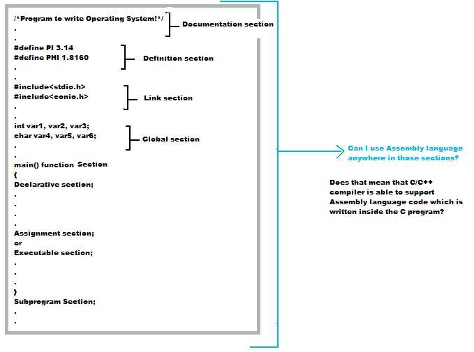

Go to Source Forge and look at the source code for the operating systems that they list. It is all open source, usually well commented, and you can see what was done and why.
Today most OS's are a combination of C and assembler code. You can embed asm into C code and do what you want done faster that way.
Paul

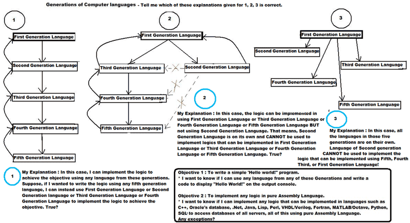

Did I understand Paul's words correctly? Please see the figure. Figure 1.
Okay. Thanks for your guidance. You all might have already understood that I was trying to draw an outline so that I can get good intuitional understanding of the subject and that will make me likely to grasp the subject in its entirety. And with considerable efforts, later I can connect the dots seamlessly. Sorry, I did not mean to ...rush in my earlier post.

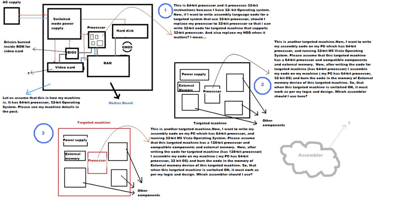

Question1:
I want to write assembly language code for 16, 32, 64, 128-bit processors on the machines that run 32-bit or 64-bit (or possibly even higher bits!) Operating system. I want to start with 16-bit, 80x86 processor architecture and later move to processors that support/accept more number of bits for processing, like 32-bit processor or 64 bit processor or 128 bit processor at once and so on. I may even change my machine on which I am going to write my code for the target machine. Currently I am using 32-bit processor, detail information about my machine is given above. Do I have to change my 32-bit processor computer machine if I want to target a processor that takes 8-bits or 32-bits or 64-bits of inputs? Which assembler should I used? Please see the figure below. Figure 2.
As I already suspected and predicted earlier that there are going to be problems for me in using and finding a good assembler. I did some reading on FASM, NASM, MASM, TASM. Each of them have their limitations. MASM only good for windows. TASM not free and maintained properly, NASM supports few things but is only good for 32-bit processors. I found FASM to be good but it does not have much parsing power.
I am not a master in programming using Assembly language but I want to work dedicatedly on this so, I want and I wish atleast one assembler to be perfect. Like say, having AASM (Awesome assembler). Do we have anything like that? I mean someone should be able to say, "just take this assembler buddy and you should be able to use it to program anything using assembly language on any processor architecture whether 16-bit, 32- bit, 64 bit, 128 bit and so on and on any bit Operating system, like 16-bit, 32-bit, 64-bit ...and 128-bit!" No, I am not picky, I just want to be able to do my work perfectly, like everyone else in the league. Please see the figure below. Figure 3.
Question 2:
Please tell me about 128-bit processors and can the number of bits supported by a processor go beyond 128-bits. Can we see 128-bit Operating system in the future? And can we create a HDD that can allocate so many(how much exactly?) memory location and give each memory location a unique address, so that I can store data into those memory locations? How will RAM that supports 128-bit of information and carry 128-bit of information to the processor and HDD going to look like? Is there a possibility to go beyond 128-bit on HDD, RAM, Processor?
EDIT:
Figure 4.
I am going to change my picture. Please wait. ...Fixed. Please answer my questions that are in the figures of this post (post#13).

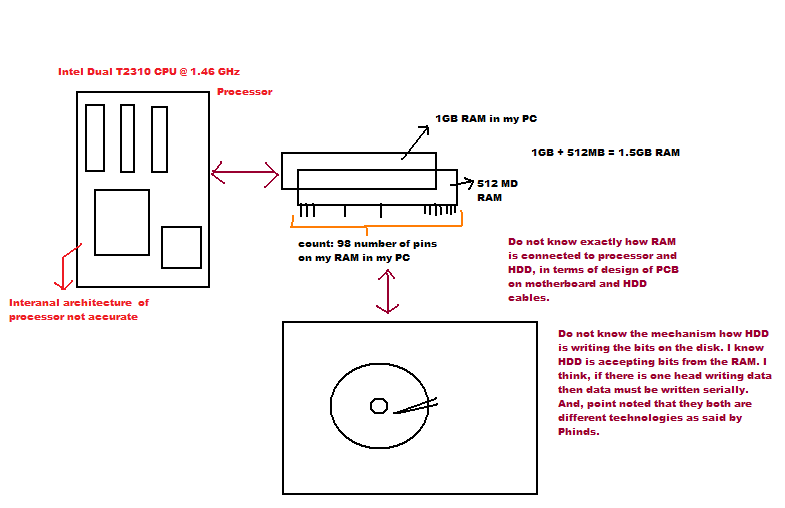

There is no conceptual limit to processor word size, but it will not be compelling for quite a few years to move beyond 64 bits for normal computer use.
HDD and RAM have little, if anything to do with each other. They are totally different technologies and your confusing the two / equating the two is not helping your understanding of computers.
EDIT: also, you continue to confuse O.S. size and computer word size. They are not the same. You can run a 32 bit operating system just fine on a 64-bit machine (but you can't do the reverse).
I find your colored graphics / lettering unreadable, so can't comment on any of them

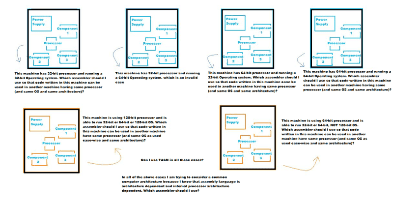

I want to start with 16-bit, 80x86 processor architecture.
Just use MSDOS either directly or in a virtual machine. MSDOS runs in real mode, which is 16 bit. Just don't use any 32-bit prefixes on the instructions.
Quote by pairofstrings View Post
32-bit processor or 64 bit processor.
You can get XP, Vista, or Windows 7 in 32 bit or 64 bit mode. The 64 bit OS's can run 32 bit code.
Early versions of MASM predate any version of Windows. Masm 6.11 can be used to generate code for MSDOS or any environment that will run with 8088 (8 bit) or 8086 (16 bit) processors.
128-bit processors.
From Wiki: There are currently no mainstream general-purpose processors built to operate on 128-bit integers or addresses:
