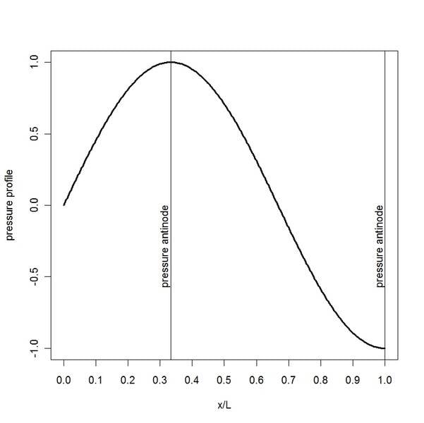

Wow. I was very confused before, but this cleared a lot of things up. I think you made one mistake though; the bolded 1/3 point should be 1/2, right?
No, it's 1/3. See attached.
That makes sense. Thank you!
