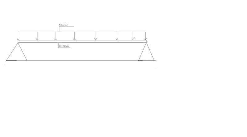

Hello all, new member and amateur engineer from Tucson, AZ. I am working on a homebuilt, part 103 legal, ultralight project. I am trying to find the formula for deflection of an aluminum tube. I need to know how much weight will cause permanent deformation of a tube suspended between two points. I have the material properties of 6061 T6 aluminum, but none of the formulas seem to take into account the hollow section of the tube and wall thickness. I know a simple formula exists, I just can't find it.

There are various equations for deflection you can use. All simple, but they vary depending on the loading of the member.
You need the Ixx, Youngs Modulus, Load and Effective Length for all of them.
You can compare the deflection from the equations to the maximum allowable and that tells you if you are within specification.
I'd recommend for rough estimates if you aren't sure what you're doing, to use one of the many available calculators online: http://easycalculation.com/mechanical/deflection-round-tube-beams.php
A general equation that may be suitable is shown at the bottom of that page.
I think the answer depends very much on how the tube is fixed at the ends. You may get permanent deformation that makes the tube go out of round, before you permanently "bend" it along its length.
The simplistic way to analyse this (ignoring the above warning!) is to find the bending moment corresponding to an the maximum allowable stress (i.e. use [itex]\sigma = My/I[/itex]) and then look at the shear-force and bending-moment diagrams to see what load will produce that max bending moment. But I certainly wouldn't want to fly in anything designed like that :eek:
Greatly appreciate the info, I think I'm getting this. I'm trying to determine size and diameter of the wing tubing. It has to withstand +6 and -4 g's as a safety factor, with the operating limits of the airplane being +4 and -2 g's. The aircraft fully loaded will weigh 480lbs, so I have two aluminum tubes running the entire 28' span, supported by struts(top and bottom) at the mid point and stainless steel tension wires at the ends, which leaves eight 7' lengths that must support a total weight of 2880 lbs(480lbs at 6 g's). That is 360lbs per 7', unsupported length. The beam deflection calculator doesn't specify type of aluminum or temper. It also doesn't specify if it is uniform load or not.
Many beam structures (iincluding yours if I understood it correctly) are statically determinate, so the forces and stresses are indepedent of the material.
Obviously the amount of bending depends on the flexibility of the material, but your OP was about permanent deformation, i.e. exceeding the elastic stress limit.
If you use that criterion to size the structure, the second step in the design is to check if the spar is stiff enough not to bend too much.
But I don't know how you would set a criterion for an acceptable amount of bending - presumably an over-flexible spar could mess up the aerodynamics and/or reduce the effectiveness of control input forces, but you need to convert that idea into a number somehow.
