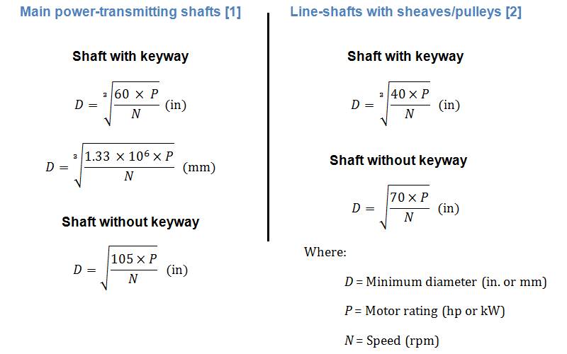

I came across the above formula at: http://www.plantengineering.com/sin...ft-size/97eb6b3f6b32adcdd181341ebbdc3224.html
The shaft doesn't have a keyway so with the above formula, based on;
1255Nm of Torque
85RPM
15HP or 11.2Kw

Using the formulae D = sqrt(105*P/N) I got
D = sqrt(105*15/85)
= 4.3 inches diameter
That's about 110mm.
D = sqrt(105*15/85)
That's about 110mm.
Where did you get this formula; why is it 105? What does that number represent?
