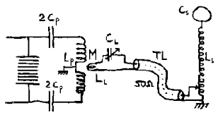

For a project I was going to build a simple 160MHz transmitter/receiver using a Yagi-Uda antenna arrangement and a resonant circuit. In some diagrams I notice that there appear to be two antenna outputs/inputs. Are these outputs spliced somewhere before reaching the LC circuit, or is one end grounded and the other attached to a part of the resonant circuit?

Something like this picture here: http://personal.ee.surrey.ac.uk/Pers...ded-dipole.gif It seems there are two outputs, and I don't know if they are eventually spliced together before attaching to the resonant circuit or if they both remain separated.

The two wire ends are regarded as one input or one output.
A folded dipole has an impedance of about 300 ohms, so you might use 300 ohm TV ribbon to connect to it, but it is similar to the coaxial connection above.
Either way, the two wires of the transmission line connect to the two connections on the antenna.
When it gets to the first tuned circuit, it might connect to a loop of a few turns of wire wrapped around the coil of the tuned circuit.

So here are three interpretations of how this antenna is hooked up to a resonant circuit.
I'm not sure which one is the 'correct' one, but that is essentially what I'm asking. Which of these connection schemes will work best (I am assuming that for the ones where there are two distinct outputs it's being run through a co-ax wire)?

The best answer is "none of the above".
A and C have no chance, because only one of the wires goes to the tuned circuit.
B is closest, but it should not go across all of the coil.
There should be only a few turns of wire between the two wires of the coax.
You could ground the bottom end of the coil and connect the shield of the coax there.
Then connect the centre wire of the coax about 20% of the total length the coil from there.
If you do use coax, it would be better to use a simple dipole rather than a folded dipole. This is because coax has an impedance of 50 or 75 ohms and this is closest to the impedance of a dipole which is 72 ohms.
A folded dipole needs 300 ohms.
Post No 2 shows a simple dipole.

So is this what you mean by only a few turns of wire between the two coax terminals?
Is there a formula to calculate the optimum spacing between the two turns of wire? The resonant circuit I'm using will at most have 6 turns of wire in the inductor.

Yes, that would probably work. You might find that the coax needs to be across only one turn of the coil. Or, you could make a single turn and place this around the main coil. One of the diagrams in this thread shows how to do this.
The tapped coil is just like a step-up transformer. Its main function is to avoid loading the tuned circuit too much. If it was loaded too much, then it would tune very poorly.
There are formulae for such things, but it is easier to just try it and see.
