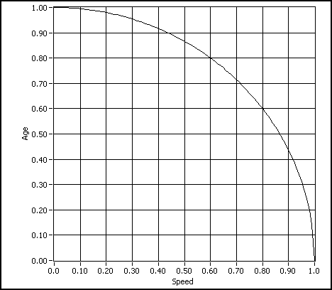

Here's how it works: you select the speed that the rocket travels at relative to the earth. As Dave pointed out, you can't actually go at a speed of 1 (all the way to the right hand edge of the graph) but you can come as close as you want. However, it's very difficult to tell what the actual numbers are on the graph when you get so close to the right hand edge so let's just say that the rocket is going at 80% of the speed of light. That would be a speed of 0.80. Then you go up to the curve and you see that the age is 0.60. That means that if 4 years passed on the earth, 0.60 times 4 or 2.4 years will pass for the travelers on the rocket. At a speed of 0.90, the age is around 0.44 times 4 or 1.76 years. I think you can see that at a speed of 0.99, the age is around 0.10 or .4 years. At a speed of 0.999, it's going to be very small but it's hard to tell exactly how small.
ghwellsjr said:
Since you don't want an answer with math, I won't show you the simple formula to calculate relative aging as a function of speed (as a fraction of the speed of light) but here is a graph that shows the function:
Boy do I wish graphs like this were on logarithmic scales...

btw, dear ghwellsjr - I can;t see the graph picture showed. I don;t know why my page doesn't show your graph picture ...
