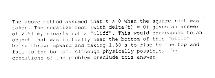

hi Peter, hope all is well. In this specific problem, the cliff is determined to be 246 meters. The bottom third would then be a height of 82 meters.
I completely agree that if someone were at the window on the seventh story of a 10 story building and threw a stone at the same time as a dropped stone reached the 7th story, then both stones would reach the floor at the same time, and someone passing by would not know which stone was thrown and which one was dropped - hopefully the passerby is wearing a hard hat.
However, the bottom third of this cliff is 82 meters, so if someone was at an 82 meter mark on the cliff and threw a stone with the same velocity, then both stones would take 1.3 seconds to hit the ground. Completely makes sense. However, 82m is definitely much higher than 2.51m. Surely you aren't implying that he threw the stone at the same velocity starting from 2.51 meters, it would only take a small fraction of the time for the stone to cover the distance of the bottom 2.51 meters of the cliff. And I definitely would probably never be able to throw fast enough to perfectly match the velocity :)
So, where does the height of 2.51 meters come into the picture?
IS that your answer, or an answer from the text?
Both of course :)
It is in fact an answer that corresponds with the text.
246 meters is the height of the cliff.
Within the problem there are two different times to solve for. Time it takes the rock to fall the total distance. And Time it takes the rock to fall 2/3 the distance.
The difference between those two times is equal to the time it takes for the rock to fall the final 1/3 distance.
So setting the equations for (time of total distance) - (time of 2/3 distance) = (time of final 1/3 distance)
Then, solving for height produces 246m.
Then there is a part b to the question, which asks something like:
When solving for 2/3 time, you get a positive and negative time. If you use the negative time instead of the positive time to find height, what does that height represent?
And the text I attached, is the supposed answer I found on the internet.
So instead of (time of total height) - (negative time of 2/3 height) = (time of final 1/3 height) And then solving for height produces 2.51 meters.
And the question askes what that height is referring to.

OK I get it now - I just hadn't seen you derive that final figure of 246 m, which I had calculated but not shown you.
Note: Did you also see the g value cancel out as you worked through the problem, meaning that if the final 1/3 of the drop is covered in 1.3 seconds, then the full drop lasted 7.08434 seconds regarless of which planet you conducted the experiment.
Of course in weaker gravity on the moon, the cliff would not have been as high, and in stronger gravity on Jupiter - it is even higher.
I will now try to find the 2.51 for you.
