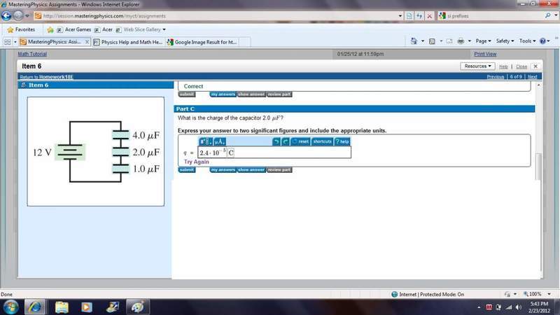

Problem is in paint doc...
My solution: Multiply 2.0*10^-6 by 12 volts... what am I doing wrong?
For a capacitor Q = C V, but V would be the voltage on the individual capacitor.
There would be 12 volts across the three capacitors in series. The 2 uF capacitor would have a voltage different than 12 V.
