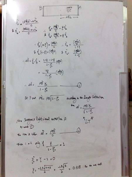

Adel Makram
632
Please refer to the attached diagram
The train moves in the direction B-A
If the events seen in the ground observer simultaneously, it should be seen at A before B in the train
In special case, the difference in times between A and B according to the train observer could be equal to the time a light signal takes to travel from A to B only if v/c=0.618
However, if the light travel from A to B relative to the train observer, it should do so relative to the ground one as well. But because of the experiment setup, still the ground observer sees the 2 events happen at the same time
So what will be the events relative to the ground observer, a time-like or space like?

OK,,, but according to my calculation attached here, the Δt` between A and B for the train observer can be equal to the Δt`taken by a light signal from A to B in case of v/c=0.618. This yields a time-like separation !
In the first sentence (in the attachment), you're talking about A and B as if they are events. Later you're talking about them as if they are locations in space (specifically in the slice of spacetime that the ground considers space). This makes your argument quite confusing.
If A and B are events, it only makes sense to say that a light signal is sent from A to B if their separation is lightlike, but this would of course immediately contradict the earlier claim that there's an inertial frame in which A and B are simultaneous. Then you start talking about calculating the time it takes the signal to go from A to B. By then you are clearly thinking of A and B as locations, not events. The signal would be sent from an event E on A's world line and received at an event F on B's world line. The separation between E and F is obviously lightlike.
I meant A and B as events
If A and B are simultaneous for the ground observer, they must have a spacelike separation for the train observer. This should not permit Δt` to be long enough to allow B receiving any light from A. But that may happen if v/c=0.618 !
Then your calculation doesn't make much sense. You wrote "AB", meaning "the distance in space between A and B in the ground's(?) rest frame". That's OK, since A and B are by assumption simultaneous in that frame. But then you multiplied AB by ##1/\gamma##, expecting to get the distance in space between A and B in the other frame. The concept of distance in space in the train's frame between A and B doesn't make sense, since A and B aren't simultaneous in that frame. What you're calculating this way is the distance in the train's frame between the two points on the ground where A and B occurred. This is not a distance between A and B. It's the distance in the train's frame between A and and an event C on the world line of the point on the ground where B occurred. C would occur significantly later than B, but still not late enough to receive a light signal from A.

The distance AB` for the train observer won`t change because he sees the event A happens before B. He always considered A and B simultaneous whenever he measures AB` as a distance.
The derivation of Δt` according to LT is also based on that assumption and therefore multiplying AB by ##1/\gamma## to yield AB`. So multiplication by ##1/\gamma## occurs on both sides of the equations i & ii and it will cancel each other out
And even if you don`t want to consider ##1/\gamma##, no problem, as the quadratic equation still remains valid because AB` will cancel each other out again
##(AB)/\gamma## isn't the distance between A and B in the train's frame. There's no such thing as a distance between A and B in the train's frame, because A and B are not simultaneous in that frame. ##(AB)/\gamma## is the distance in the train's frame between the points on the ground where events A and B occurred. It's a distance in spacetime along a simultaneity line of the train's frame. There's such a simultaneity line through A, and another one through B, but there's no such simultaneity line through both. So ##(AB)/\gamma## is definitely not the distance in the train's frame between A and B.
I think you need to think about what you're actually calculating using the length contraction formula. You can't plug in the distance between two events and expect to get the distance between those same events in another coordinate system. That's not just wrong, it doesn't make sense. Think about it this way instead: In a spacetime diagram where the axes are the t and x axes of the ground's frame, the world lines of the two points on the ground are vertical lines. A and B are two points on those two lines. Since they are simultaneous, there's a horizontal line that goes through both of them. The length of that line segment from B to A is what you called AB. But ##(AB)/\gamma## is the length that an observer on the train would assign to a line with slope 1/v between two events where such a line intersects the two vertical lines.

In this occasion, I was not talking about the distance Δx` between places where A & B occur, but about the distance between the 2 train ends A and B. Your calculation is right that the Δt`=[itex]\gamma[/itex]vd/c[itex]^{2}[/itex]. OK, so can this time difference allows a timelike separation between A and B if a signal would take off from A to reach B?
In other words, if the train observer emits a light signal from A once A happens, can that signal reaches B before or at the same time when B happens?

Adel, you have indeed discovered a special speed, but it's not really significant. Here's how I would explain it:
If you use a distance in the ground frame of 1 (using compatible units like seconds and light-seconds and where c=1 and speeds are expressed as beta which is v/c) and you set the first event at the origin (all components equal zero), then as you increase beta from 0 to almost 1, the value of the reciprocal of gamma goes from 1 to almost 0 and the absolute value of the time coordinate of the transformed event goes from 0 to almost infinity. At some particular value of beta, these other two values will become equal. This value of beta is 0.618034 and the reciprocal of gamma is 0.786151 and the time component is -0.786151.
But what does this mean? Nothing at all.
In order to compare a length of an object in one frame to its length in another frame, you have to do it when the events at both ends of the object have the same time component. Clearly, in your discovery, those two events do not have the same time component (one end is at the origin with time equal to zero and the other end has a time component of -0.786151) and so the length component, which will be equal to gamma or 1.272020, is not the correct length to use. What you have to do is pick another value of time for the second event in the original frame such that the value of the time component of transformed event is zero. This is very easy to do when you normalize the problem as I have, you just set the time component to the value of beta. So if you set the time component for the second event to 0.618034 (with x equal to 1) then the transformed time component is 0 and the distance component is 0.786151 (the reciprocal of gamma). Of course, if you wanted to use any other distance, you would multiply beta by the distance to get the correct time component to use and then the transformed distance would be the original distance divided by gamma.
So the bottom line is that in order to see what length anything is in any frame, you have to make sure the time components at both ends are equal. The corollary to this is that if you want to see what a time interval is in any frame, you have to make sure the spatial components are the same at both events. Now it should be pretty obvious that there cannot be a single pair of events for which both of these conditions are satisfied, that is, you cannot use the same two events in any frame to know both the length and time intervals in any other frame.

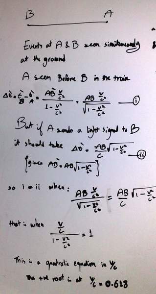

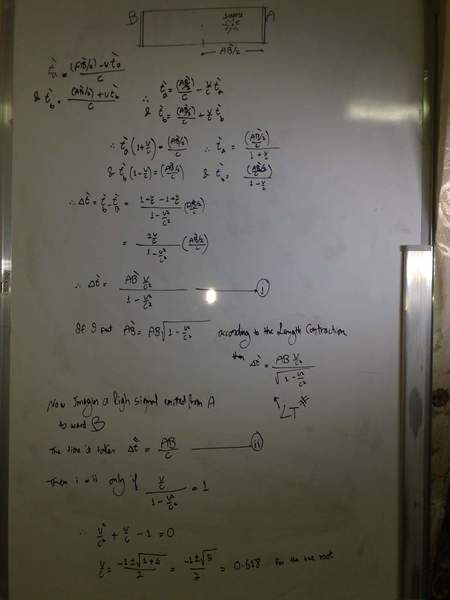

Adel Makram said:
https://www.physicsforums.com/attachment.php?attachmentid=44642&stc=1&d=1330705974
Here is my calculation
This can be also considered as simple derivation of Lorentz transformation up to the equation (i)
Now no worries to assign A and B to whether events or train ends as long as we are talking from the perspective of the train rest frame
the second image is more clear and accurate
https://www.physicsforums.com/attachment.php?attachmentid=44643&stc=1&d=1330706663

No worries? Maybe you need to think that over.
I can't decipher all that, but I get the impression that there is still confusion between these two things:
- the distance between the two ends of the train in a certain frame
- the distance between the locations where the two events occur in a certain frame.
If you could type your argument in a post, complete with explanations of the steps, it would be easier to see what is going on.

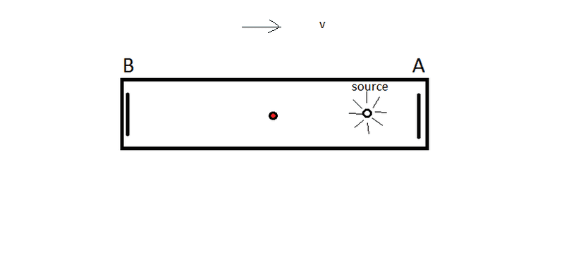

Suppose that a light source is put near the A end of the train so as to be seen simultaneously at A & B for a ground observer. It will be definitely seen at A before B for the train observer. Now can this time difference allows a timelike separation?
https://www.physicsforums.com/attachment.php?attachmentid=44641&stc=1&d=1330703748
You're rehashing the same situation you brought up in Is the order of the events reversed here? and we're having the same problem in this thread that we had in that thread--you aren't precise and clear in what you are presenting and we can't tell what you are talking about.
