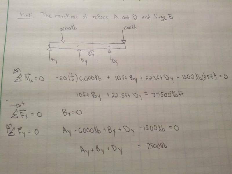

Pin C joins members ABC and CDE
Sum of moments at a point = 0
Sum of vertical forces = 0
Sum of horizontal forces = 0
Weight of triangle acts as a force at its centroid (1/3) its length according to this figure.
See pictures.
I get 2 equations with 3 unknowns.
10By + 22.5Dy = 77500
Ay + By + Dy = 7500
Any advice what to do next?

Since it says Pin C joins members ABC and CDE, does that mean I can take each part and sum forces to zero?
Such that working with CDE Dy = 1500 allowing me to decouple the other two equations.
Just a thought. Not sure.
