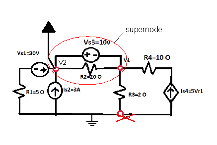

beanus
Find the node voltage method equations. Do not solve
Find the mesh current method equations. Do not solve
None
Using nodal analysis:
Node v1 : -Is4+(v1-v2)/2+v1/20-10=0
Node v2 : Is4+(v2-v1)/2+3+(v2-30)/5=0
Looking at this I feel like v1 is just -10 and v2 is just -30. But that can't be right can it?
Using mesh analysis:
I set up my meshes from left to right, and then up. So the left most mesh is i1, the one to the right of it is i2, the far right is i3, the top is i4.
mesh 1 : -30+V_(is2)+5i1=0
mesh 2 : 20(i2-i4)+2(i2-i3)-V_is2=0
mesh 3 : 10i3+5_vr1+2(i3-i2)=0
mesh 4 : 10+20i4=0
I understand the principles of this, but this circuit is really confusing me. Thanks in advance for the help!

You're mixing voltages and currents in the Node v1 equation. "10" is a voltage.
When writing node equations you should first identify a reference (ground) node. That node will be the zero reference for all the other node voltages that you determine. In this case the node that you labeled V2 looks to be a good candidate. Next you should pick out any nodes whose potential differences are constrained by fixed voltage sources. These can be combined into "supernodes". Currents into and out of supernodes reference only a single supoernode potential, with appropriate fixed offsets (due to the fixed voltage supplies). In your circuit your node labeled V1 has a fixed 10V supply connected to the node to its left, so that comprises a supernode.

Ok I revised my node equations
v2-v1=10
(v2-30)/5-3=0
v1/2-Is4=0
I'm not sure how to go about taking care of is4 in this case

Rewrite your node equations; you've really only got one node, the supernode I indicated, so V2 won't appear in it (because V2 is just V1+10). Be sure to replace "5*Vr1" with an appropriate expression based upon the voltage that appears across R1 due to the supernode voltage across the branch containing R1.
Is4 is not I2 - I3. Is4 is I3. (well, -I3 if I3 is taken to be clockwise). Is4 will be constrained by I1, right? since I1 flows through R1. You still need to write the constraint that Is2 imposes.

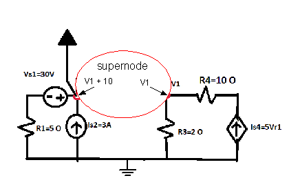

Still having trouble understanding the whole constraint thing, but this is what I've done.
For the nodes
v2=v1+10
(v1+10-30)/5-30=0
(v1)/2-5(5*i1)=0
For the meshes
Is4=5(5*i1)

Okay, you've still got a voltage (30) stuck in a current equation. What's it there for?
Also, there should be one node equation that represents the entire supernode (KCL sum of currents entering/leaving that supernode). Then the constraints are applied, such as the Is4 current source being equal to 5 x the voltage across R1. You can write an expression for that voltage if you determine the current through R1 in terms of the supernode voltage at the top of its branch.
For the meshes
Is4=5(5*i1)
What about Is2? What does it constrain?

v2=v1+10
(v1+10-30)/5+v1/2-5(5*i1)=0
Is the current through the left branch equal to 3?
So the second equation becomes
(v1+10-30)/5+v1/2-75=0?
Or is the current in the left branch equal to (v1+10)/5? or (v1+10)/5+3?

You're getting there :smile:
Since there's no known "i1", you'll have to write an expression that will will give you Vr1 based upon the given variables. In this case you can write a KVL expression for the branch starting at V1, passing through Vs1 and R1. The sum must be zero.
The current in the left branch (which would be your "i1") is given by:
(V1 + 10 - 30)/R1
which was the first term in your first equation above.
Be sure to include Is2 which also flows into the supernode :wink:

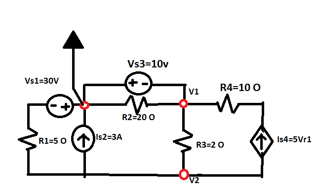

Quick question. I've been ignoring the line with the big arrow at the top of the circuit. Is it significant? It just occurred to me that it might represent an infrequently used version of a ground symbol... in which case your ground point is being forced upon you and your choice of independent nodes would change... :frown:
Oh duh. Vr1 is just found by doing the regular node stuff the branch with r1.

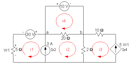

So that means the mesh equations are
-30+V_is2+5i=0
20(i2-i1)+2(i2-i3-Vis2) = 0 (add the first two equations to cancel Vis2)
10i3+is4+2(i3-i2) = 0
10+20i4 = 0
is4 = 5(v1+10-30)
Is that right?
That is the ground point that I set for it. I made this circuit in paint based on something I found in the book. I just wanted to do this problem for practice because it seemed difficult.
Our book uses the black delta as ground.
Ah. Alright. I hope my change of reference node didn't confuse you.

Let's start with a new figure with the mesh currents labelled:
Your first equation looks okay.
Your second equation has i1 flowing through the 20Ω resistor, which is not correct. It should be i4. V_Is2 should not be inside the brackets for the current flowing in the 2Ω resistor.
In the third equation you should use V_Is4 to begin with (later you can get rid of it when you realize that i3 is just -Is4).
In your fourth equation you forgot to include i2 flowing through the 20Ω resistor.
For the fifth (constraint) equation, there is no V1 in the mesh analysis. Use i1 for the current through R1.
You need one more constraint equation which relates I1, I2, and Is2.
