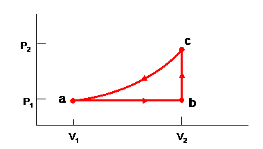

An ideal monatomic gas is taken through the above cycle where p1= 2 X 105 Pa and V1 = 5 cm3. During the cycle both the pressure and volume will change such that p2 = 2 p1 and V2 = 4 V1.
a) How much work is done by the gas in going from state a to state c along path abc?
Wabc = 3 J

b) What is the change in internal energy in going from b to c?
Ubc= J

d) What is the change in entropy per mole of gas in going from b to c?
ΔSbc = J/K

I am having problems with Parts B and D.
PV=NRT
Q = nCvdt
I only have P and V. I cannot use the Ideal Gas Law to calculate n or T because I have two unknowns. I cannot use my Heat Equations because I am still missing n and T. I'm just stuck. If I can calculate B, I think I can get D...I just don't see any way to calculate the Heat in part B. HELP!
Ubc= J
Use: ΔU = nCvΔT = n(3R/2)ΔT
Since PV = nRT, you can express ΔT in terms of ΔP and V (V is constant).
ΔSbc = J/K
Use: dS = dQ/T. What is the heat flow in terms of dT and Cv? Integrate that to get ΔS.

I can't believe I didn't see that. Once I read "express ΔT in terms of ΔP and V" it all fell together. It took me less than 2 minutes to solve the problems. Thanks! :)
