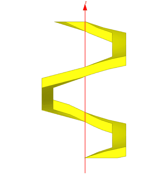

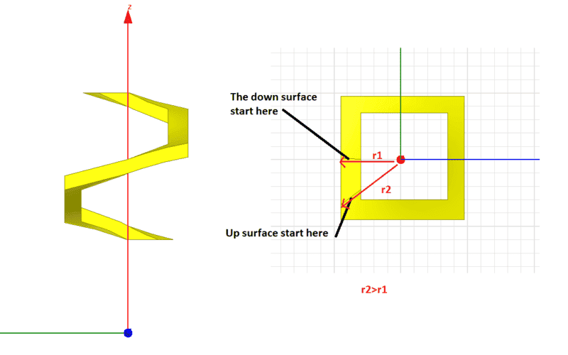

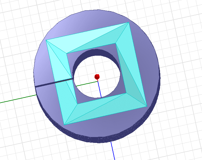

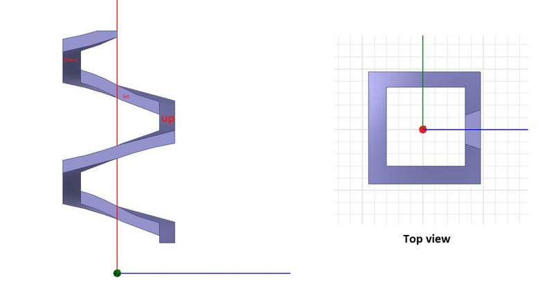

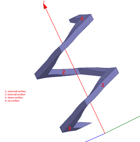

Hi,
I would like to calculate the torque on a color square screw full with water like the drawing show. All grey screws don't move or turn, only color screws can turn (and so move up or down). Color screws are square (see top view for that). There is water between color screw and grey scew (gaskets are not visible ! ;) ), so like that the only faces can put forces are external and internal faces.
The problem for me, I see at each corner a small torque (because the altitude is not the same) but I don't find where this torque is cancel by another part of the screw. Can you help me ?
Maybe you need some others views, don't hesitate to tell.
Thanks :)

This is like I see forces but maybe the weight is not full at bottom ? I'm drawing only a corner like that it's better for see where is another torque.

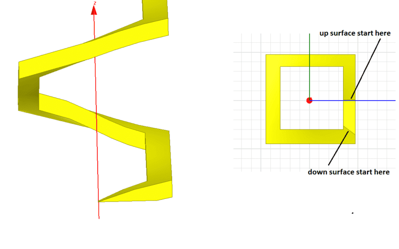

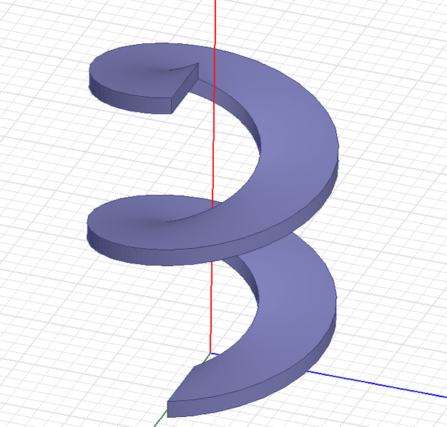

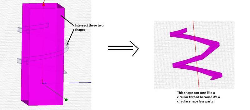

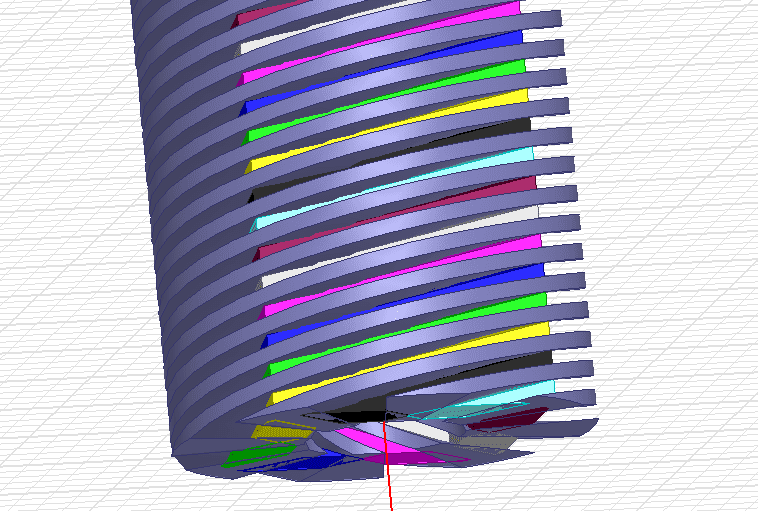

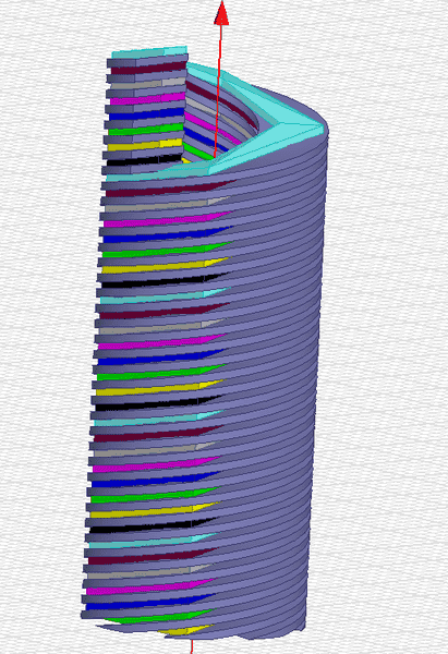

I add some views of the thread.
I have cut 3D circular thread (first drawing) with 2 rectangular cuboids for obtain square thread (second and third drawings). Like that I'm sure the square thread can turn in the circular thread.
If you look at the square thread you can see a torque when the thread is in water due to external/internal surfaces. This torque is cancel by another torque with up/down surface. But it's easy to cancel this last torque if you put this square thread in a circular thread. So, another torque must cancel all torque but I don't find where. Maybe you can ?
Thanks

I' not sure I have understood the problem, but if you consider that the forces due to hydraulic pressure is normal to the surface ( which I'm sure you do), the problem is solved.
I think you can simplify the problem to a simple slab in the water. Wouldn't it be the same problem?
Hi Hassan2 ;)
Yes, forces are normal to the surface, can you explain more I don't understand how ext and int surfaces give no torque ?
Up and down surfaces can be canceled so we rest with ext and int surfaces. Really, look at the drawings, you'll see a torque due to the corner. I don't think this 3D shape can be resume with a 2D shape.
thanks
The hydraulic force on any differential( infinitesimal)surface in any direction is equal to the force on the projection of the differential surface on the plane perpendicular to that direction.
Any differential surface at any point on the screw has a projection on the plane of the axis and r ( r being the vector from the axis to the point)being the distance from the axis). There is another differential surface on the other side of the plane the same projection on the plane, thus exerting equal forces in opposite directions.
This is true for any arbitrary shape.
About the torque on the screw in the figure, The force on the upper and lower sides are not equal. the torque the net is canceled by the net corner force.

In one of your figures, I see the words " up" and "down". My up and down surfaces are both sides of the thread separated by the thickness. The are not equal because they are like two parallel surfaces at different depth.
The problem is, there are 2 thickness: up thickness and proof thickness. See the drawing below. Imagine air gap for up and down surfaces like that we sure there is no torque from these surfaces and we sure this cost nothing in energy if we turn in circular threads. But external and internal have a torque, for me, sure ;)
Drawing: look at "Z" axe

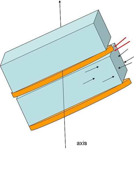

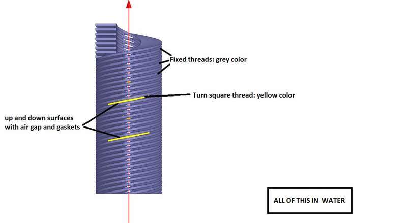

It's not a problem to cancel the forces on these surfaces if we put small air gap (with gaskets) and put in a "sandwich" in 2 fixed circular threads. This cost nothing (in theory) about energy.
I add a drawing with a square thread in a "sandwich" of circular threads. Air gap at up and down surfaces.

Thanks for the explanations and the figure. I think I understands the problem now. In this simplified problem, no water touches the up and down and also internal surfaces. The problem becomes interesting and challenging now. Think of the proofs ( gaskets, fillers,..); They experience the same but opposite forces. If the gaskets are free, they transfer the force to the internal surfaces of the screw and cancel the forces on the screw. If there are rind connected like "another" screw, the forces cause a torque which tends to rotate the opposite direction the screw tends to rotate. Again no net torque.Added: Sorry in case of a rigid proof, my description may be incorrect.
Thanks to you for your help ;) it's friendly
It's more difficult to think with the internal face without water because gaskets will be great with important surface. Or maybe I don't understand your explanations. Tell me ?
For my experience (no water at down and up surfaces but water at internal and external surfaces), the air gap could be like 1µm so the surface of the gasket is very small and this can't cancel the torque I see on internal/external surfaces. The weight can't be changed because internal/external surfaces are verticals.
Yes, but with water touching the internal faces too, again there is a net torque on the screw as you said before. But again the gaskets cancel the torque. If the gaskets thickness is much less than the screw thread, much of the forces on the thread is canceled by the forces on other side of the thread the remaining is canceled by the gaskets. If the thickness ratio is not small, again the number of gaskets must be large.
My problem now is with the case of the rigid gaskets fixed to the water container ( pipe). I have no explanation for this yet.
by the way, what software do you use for draw such figures?
You said that the gap is filled with air? it must be pressurized air, the same pressure as the water pressure. If so, it tells you where the cancelling force come from!
An air gap with air at pressure 1 bar for example, this air will apply the same force all along up and down surfaces, it's easy to do, and this cancel the pressure of water like that we can forget these surfaces (they have the same surface) and think with only external and internal surfaces. I use Maxwell (electromagnetic simulator) but I think you can do with Blender (free) but I don't know how.
it's evidence that the external surface apply much torque than internal surface but need some calculations for be net.

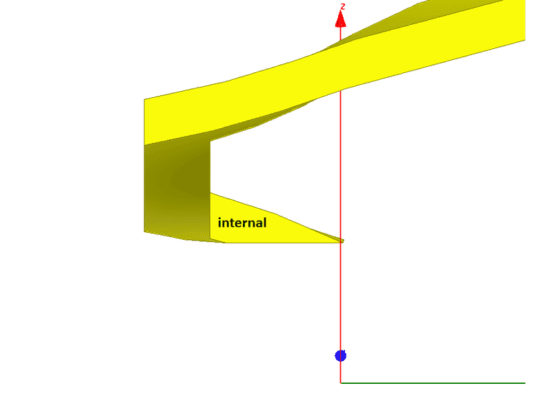

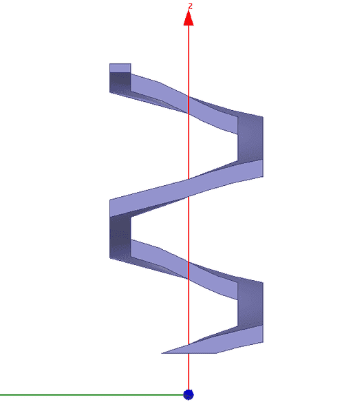

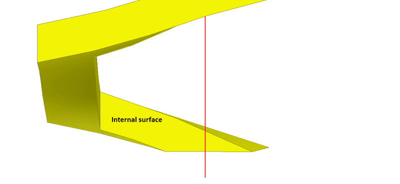

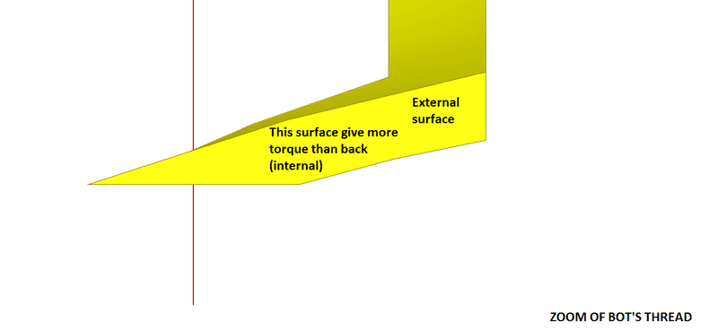

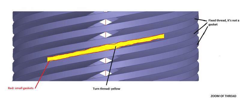

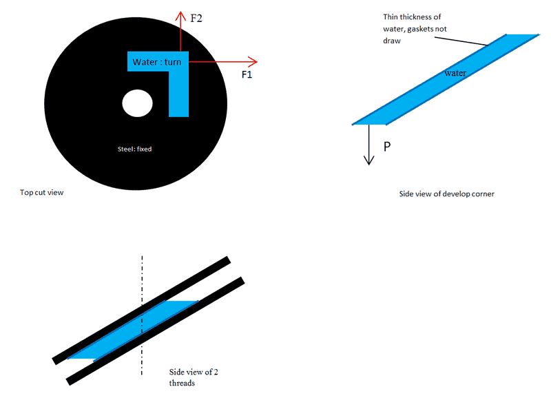

I put two 3D drawings:
1/ a zoom of the bottom of the thread (yellow), we can see the difference of altitude of the thread and this show there is a torque with external/internal surfaces,
2/a zoom of the thread in sandwich with anothers fixed thread. I put the gasket extremely thin 1µm between yellow and grey threads. This don't cost energy. And inside (the volume create by gaskets which is between up/down surface and grey surface) there is no water only air.
I have questions:
a/ are you agreed with the torque with only 2 surfaces external/internal (don't think at another surfaces) ?
b/ Why do you think the torque is proportional with the thin of the torque ? The thickness of the square thread don't change with the thickness of the gasket.
c/ orange color of your drawing is gasket for you ? Because for me not at all. See for that the zoom.
Thanks for your help ;)

I have draw new thread like that no problem with part of the axe Z.
Maybe it's more easy to see where I see a torque ?

You're welcome,
Thanks for your patience. I often forget what you have already explained to me. In in my posts, replace gasket by "fixed threads". That's fine
answers:
a. Yes, in your figure, where the gasket has sealed the space, hydraulic force is on external and internal forces only. But I see another force there. That is the force on the up and low surfaces of the "fixed thread. The net torque on the turning thread due to direct hydraulic pressure is non-zero. The force on the upper and lower surfaces of the fixed thread causes an opposite torque and they are canceled out. Just like when the turning and the fixed threads were welded to one another.
b/ Since I had confused the gasket and the fixed thread, I change my statement now. It depends on the ration between the thickness of the fixed thread and the turning thread which seems to be near one. I tried to show it in the figure. Just imagine a very thick turning thread with a thin fixed thread, then for most of the surfaces of the turning thread, the there is another point on the the forces on both sides. Although we don't need this argument anymore, a reason is that when the distance between fixed threads is high, a higher portion of the turning thread is exposed to two-sided hydraulic pressure.
c/ Sorry for the mistake, the orange is the fixed thread. The gaskets are ignored.
The fact behind all the discussion is that the fixed and turning threads are being pressed against each other by water pressure, and this is very usual and causes no net torque.

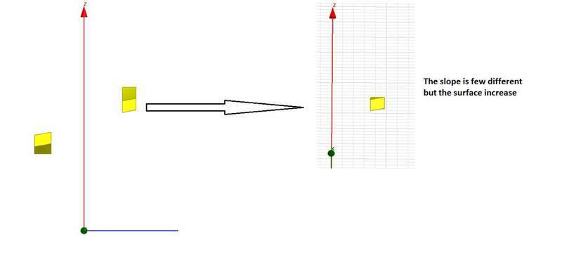

Usually, the difference of surfaces at bottom must compensate the torque but they can't because I can choose this difference more in front of the axe. Another manner of thinking, it's increasing the radius of the thread and don't change thicknesses of square thread, this will change the torque but not at bottom. I think I will calculate this.
Another problem is if the pitch of the thread increase the difference at bottom section decrease but the torque not.
Sure the difference of the surface need calculations. I will try later.

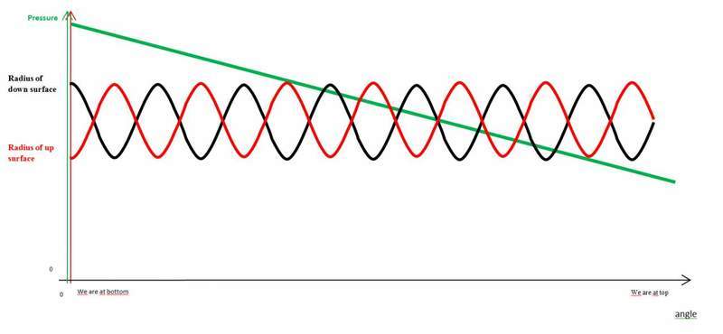

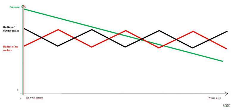

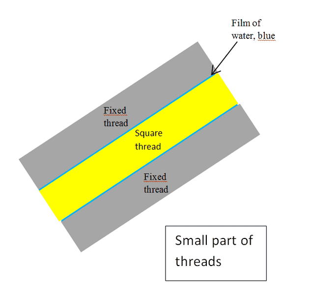

For now, I have another case with this square thread.
Imagine this new case:
1/ All system in air, not in water
2/ An empty square thread with air inside at P=0 (it's a theoretical study), Weight of this square thread = 0 Newton (theorical)
3/ Put the square thread in sandwich between two fixed circular threads
4/ Put water on up and down surfaces only. Extremely thin thickness of water (1µm for example), in theory the weight of water can extremely low (for simplify the study, imagine the weight of water = 0 Newton), I want the weight of water very low like that I don't think about the energy need for move up or down the water.
I want the weight of square thread and water very low like that I don't think about the energy need for move up or down the water. Sure in practise there is a small weight. In the drawing the radius is a mean radius.Now:
a/ up surface = down surface, by building
b/ total up force due to the pressure of water = total down force, by building
c/ the torque (for me) is not to 0 because there is a phase angle for the radius of application of the force, and the force is lower with altitude (pressure of water). See the drawing for that.
I hope you can understand my problem
Thanks for your help Hassan2 ;) and have a good day

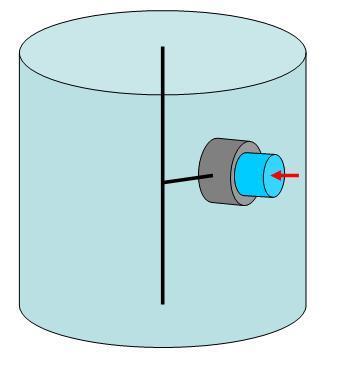

Thanks GH778,
Before we make the problem more complicated, let's discuss on a simple problem in the figure I have attached. This is to show that the forces and torques on the the fixed parts must be considered too.
In the figure, the gray cylinder is fixed to the axes. The blue piston can displace freely in the cylinder. There is air in the gray cylinder so the piston doesn't touch the button. Now, can we consider the torque due to the blue piston only and conclude that there a net torque? Of course no. For the screw problem also we can't ignore the torque on the stationary parts.
I'm ok with your drawing and torque. But take a moment for read and understand my last message because it's not more complicated, it's very easy to understand. Have you understand the phase angle ?
Thanks. That is simpler.
b/ I don't agree. it depends on the pressure profile. If the upper and lower water films are connected ( for example both are connected to the same source from the to), then the total forces on the lower surface is higher which causes a buoyancy force upward.
c/ Again if the water films are not connected ( i.e they don't have the same pressure at the same depth), there could be a net torque. The thread becomes a turbine then. In case of connected water, at any point the torque is counter balanced by an opposite torque in the other side. No matter the point is on the corner of in the middle.
Water's head doesn't depend on the mass of the water but on its height, density and on the gravity. So, the problem is equal to having the space between the threads filled with water.
b/ no, they are not connected
c/ I see a torque, but it's not possible in fact, because we don't give energy to the system but we can recover energy. I thought about the weight but the thread can be with weight near 0 N because we use pressure of water (it depend of altitude) not the weight of water.
Note: the space between square thread and grey thread is for example at 1µm but the surface is equal at the up (or down) surface so the torque is high on the up surface (or down). Sure the anlge phase is not very important torque but it seems to exist. I don't find where's the problem ?
Torque without angular velocity gives no energy/work. If the thread starts turning, The pressure balance will change and we need to to do work to keep the pressures the same.
The phase angles are eventually irrelevant because the torques are canceled at point. The torque on far points are canceled by the opposite torque on the point. Same goes with near points.
