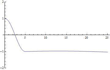

Here is a sample code mu = 6.;
width = 5.;
R = width;
Vb = 4./(2*mu*R^2);
Vs = -10./(2*mu*R^2) + Vb;
p = .3;
Energy = p^2/(2*mu);VCC[r_] =
Vs*UnitStep[width - r] +Vb*UnitStep[r - width];
eps = .01;
"Numerical Results"
system1 = {RC''[r] + (-2*mu*(VCC[r] - Energy))*RC[r] == 0,
RC[eps] == 1.0, RC'[eps] == 0.0 };
syssol1 =
NDSolve[system1, { RC[r]}, { r, eps, 50./p}, MaxSteps -> 10000000];
Plot[Evaluate[{ RC[r]} /. syssol1], {r, eps, 10.0/p},
PlotRange -> {-100, 100}]
No matter how you vary p parameter here, you always get an increasing solution. However, what I want a decaying around R, which is physical.

Thanks for your respond..
Regarding the boundary conditions;
my original differential equation is Bessel differential equations, so as you guessed I did substitution R[r]=RC[r]/r, however, the boundary conditions are correct for L = 0 (s-wave). The conditions that you suggested are correct for L>0 solutions (p, d, f...waves). As I said I tried to give a simple example to discuss.
Regarding the solution with p=0.4;
functions becomes constant for r=>R, but not zero as you could see in the attachment. Do you think this corresponds to the physical solution, I am skeptical about it.
Thanks

The value that you point out p = 0.4 corresponds an energy value the same as the barrier, so the particle is not bounded for that value.
See Landau Lifgarbagez Vol 3, section 32:
If you have the full radial Schrod equation (where you've not done any transformations) the solution near the origin (for a potential V(r) such that r^2 V(r) vanishes near the origin) is R ~ r^l.
You are right, but L=0 here. So the boundary conditions are correct. If L>0, then the w.f vanishes at the origin.
Yes but your two equations are inconsistent, in the step well case the equation appears transformed (no first derivative term), in the other one it is not yet the BCs are the same, thus something is wrong.
In any event the real answer (which I missed because I'm currently working on a relativistic problem and that's messing with my head a bit) is that you are only looking at positive energies.
