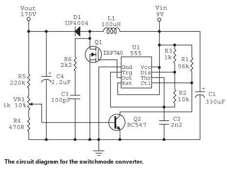

I would be concerned about your safety. Think about using a switching power supply powered by a low voltage UL approved "wall wort".
Here's a simple 555 circuit kit which uses 9vdc from http://www.ledsales.com.au/kits/nixie_supply.pdf

The best solution is to never connect anything to the mains unless you can fully enclose the resultant system.
You can't depend on the neutral of the mains always being the neutral if the device is shifted.
Although we have all done it, there should never be exposed conductors with mains voltages (or any other high voltages) on them, even when testing the device.
Isolation transformers are relatively rare and expensive.
An alternative is to use two transformers back to back.
So, if you found a cheap source of identical 120 volt to 24 volt AC transformers you could join the two 24 volt windings together (ie in parallel).
Connect one primary to the mains and take 120 volts, isolated, out of the other primary.
Wall-warts (or plug packs) often have AC outputs and sell cheaply if the device they powered is no longer working.
You can develop low voltages for control circuitry from the low voltage ouput of the first transformer.
You still have to be very careful with the high voltage produced, but at least you can ground one side of it safely.
