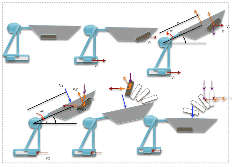

Calculating the time required for the cooking robot to flip an object
The discussion centers on calculating the time required for a cooking robot to flip a 100g object, specifically meat. Samuel initially calculated the time to be 0.2 seconds, which he deemed too low compared to the estimated 0.4 seconds from a video reference. He assumed no drag and friction in his calculations, raising questions about the accuracy of his method. The community is invited to provide insights on the validity of his calculations.

Hi, i have calculated the time required for the cooking robot to flip an object as you can see from the attached file, however, the time result that i got was about 0.2 second which 's a bit small. So I'm wondering whether my calculating method is correct or not.
Also, please note that i assumed no drag and friction.
Appreciate your help
Thank you so much,
Samuel

From the video, the estimated time require to flip the meat weight 100g usually takes about 0.4 second.
