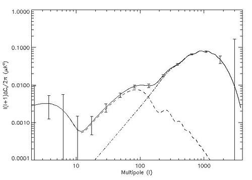

Hi chiro! Thanks for the reply, as requested I've included to plots showing what the function is (the bold line of the first graph) and how the errors vary as a function of (in this case) l which is the second graph.
The error bars in the first graph are on equally sized log bins (chosen specifically to ensure the errors are independent!) however hopefully now you can see why simply adding the variances seems to give me problems. I can for example have the first graph running to any value, from the 4000 displayed there all the way to 10000 if I wanted but the errors will shoot off to infinity as l goes large, therefore my total variance will become infinity too!
For example: If I sum the variances of the first graph there you will get 0.16... perhaps not too unreasonable but still larger than any of the variances on that graph. However if I shift how far I plot to say, l=6000 suddenly the sum of variances shoots to ~100000!
If it makes it any clearer I'm hoping to calculate a signal-to-noise ratio from graph one where the bold line is what represents the signal and the error bars are the noise.

Do you want to get your signal/noise information for a continuous signal?
In other words are you assuming that the signal is continuous (or close enough to it) and that you want to find the signal/noise ratio given some distribution for your noise that is added to the uncorrupted signal?
I am assuming the original signal is continuous yes and it has errors arising from a sum of random noise, limited sampling (low l) and resolution (high l). However the signal and errors in those two graphs are binned into log bins before calculating things like the signal/noise (to ensure they are independent measurements which is related to the experimental set up).
