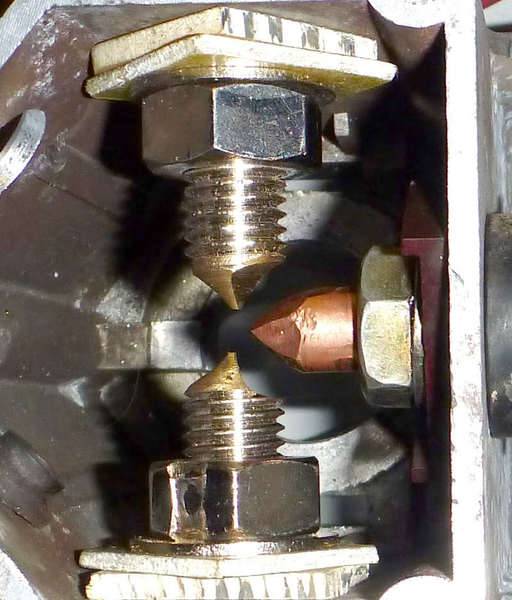

Now I am busy building a spark-gap switch or 'trigatron' as I am told it is called .
It is proving difficult to get reliability . With the first design I drilled a hole in the conductor and ran an insulated wire down the middle so that when I take a picture my camera flash triggers a 40 000 volt spark down the centre of the contacts and causes the 320 volt capacitor to jump the gap through the ionized air .

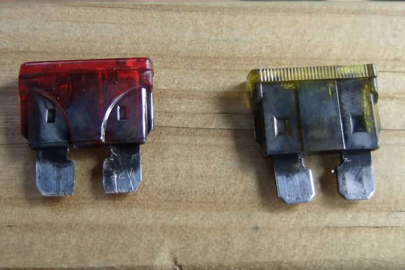

It blew a 10 amp and a 20 amp fuse on two of my attempts ...
a 40 amp fuse caused the electrode tip to blow off rather and it is proving difficult to get a reliable switch each time .

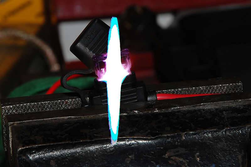

This is a 3.5 amp fuse blowing with 320 volts photographed at 1/1000th sec - the act of pressing the shutter is what triggers the spark and 'explosion' ...

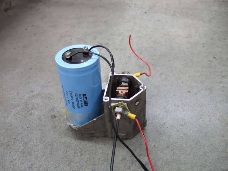

Tonight I tried a different version based on some pictures I have seen of a trigatron - it isn't switching though the contacts should last much longer this time if I get it to work ...

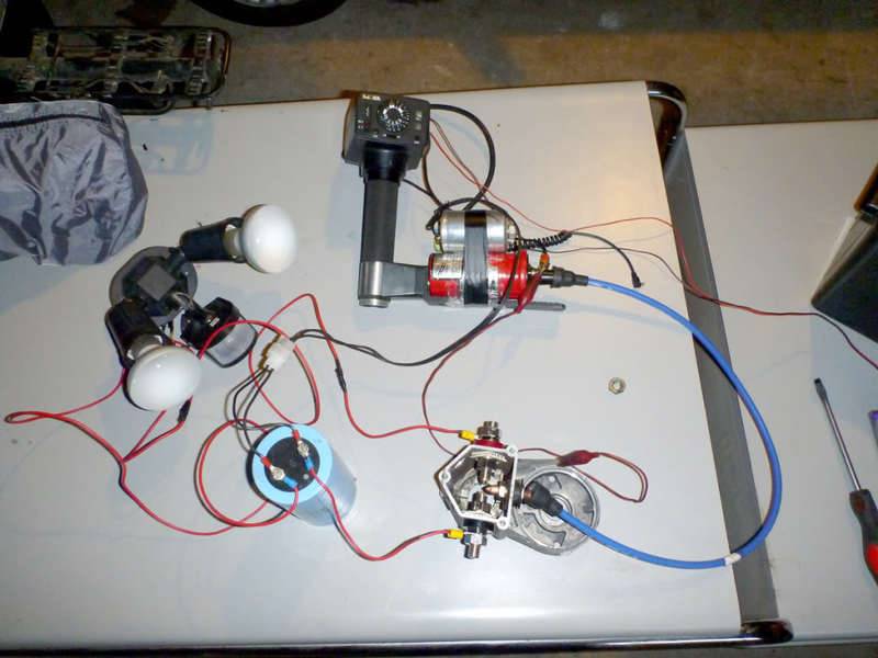

I've put some light bulbs in series with the switch to quieten the noise of fuses blowing in my garage though I'm wondering if they just can't light up fast enough for the quick switching action I would get ?
Any advice on perfecting this design for reliable switching and hopefully some really good photos would be appreciated :)

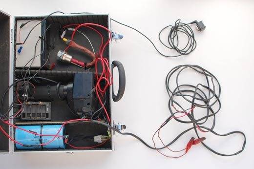

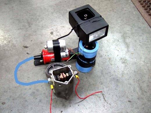

here's my last design.
I would probably have used the hot shoe switch directly rather than the current through the flash capacitor. Then the rest is electronics and depends on what exacty you are trying to trigger. Perhaps use an opto isolator to fire a triac or something.
PS: Make the Triac easy to replace if you are trying to pop fuses with unlimited current.

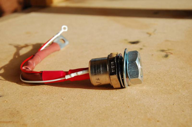

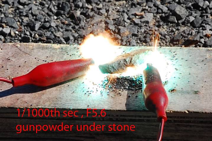

I eventually wired up an SCR to the hotshoe trigger circuit, the one I'm using is rated at 800volts and 3800 amps surge.
It dumps the capacitor across a thin piece of wire and ignites the gunpowder quite nicely.
However, I would still like to perfect the Trigatron just for fun:)
