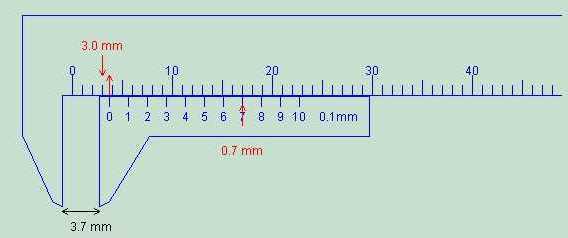

When you align example 3mm, the lower part align to 0.
You can see that unit 1 of lower scale is 1/10 nearer to main scale
This continue 2->2/10...9->9/10
If you move the vernier scale, the distance moved can be measured from initial position to final position. The one that align must be the easiest to calculate the distance moved.
well i didnt really understand that...but anyways I've got the logic
We're comparing two lengths, one is having one more no of divisions than the other.
and so on.
(since u already know I'm skipping explanation)
