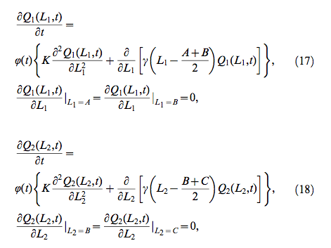

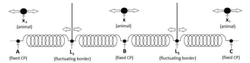

Hi group,
I'm currently trying to understand a physicists written paper on ecological models. In there, they used the term "quadratic potential" when comparing spatial diffusion with a spring system (see attachment 1). After searching online for this term, I found nothing directly relevant to the material at hand. Can someone tell me what it means intuitively, whether it's represented by a canonical equation, and if so, whether the derivation of that gives the form seen in the paper (attachment 2)? Thanks!
For the original equations the variables in attachment 2 refers to, see attachment (3).

hi nigels! :smile:
"quadratic potential" just means that the potential energy is kx2 (or k(x-a)2 if the equilibrium position is at x = a) …
it results in force being proportional to distance
for example, a spring has PE = 1/2 kx2

Thanks, tiny-tim! That makes much more sense now. However, I noticed that in the attachment, the spring constant is 1/4. Is that because the point is attached by a separate spring on both sides? Somehow that's equivalent to have two parallel springs for some reason?

θ(t) and φ(t) are just functions that modifies the diffusion coefficient K to be time-dependent.
γ is defined as the "rate at which territory sizes tend to return to the mean size", which I understand as "the rate at which L_1 returns to its initial state".
Yet still, I can't explain the 1/4 spring constant that seems to be used (in attachment #2). I mean, should the constant be 1/2 + 1/2 = 1 since the springs are in a series? It's been a while since I took intro physics..
