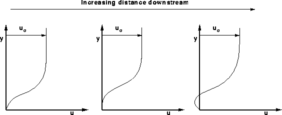

Separ8shun said:
(apart from 'pushed back'. i assume you mean that the pressure increases with distance along the chord resulting in a net force acting upstream? if you don't mean that then i am in BIIIIIIGG trouble!)
Yes. This image on Wikipedia illustrates what an adverse pressure gradient does to a boundary layer the farther downstream you go.

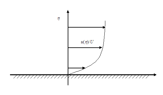

Every boundary layer is essentially just a complicated dynamical system. As such, the Navier-Stokes equations can by broken down through a stability analysis into the Orr-Sommerfeld equation. This essentially constitutes an eigenvalue problem, meaning a number of different modes can satisfy the equation and grow at a variety of different rates. Like any other dynamical system, it is sensitive to perturbations of certain frequencies and types and not very sensitive to perturbations of certain other frequencies and types.
It is also important to note that boundary layers with inflection points in them (i.e. [itex]\frac{\partial^2 u}{\partial y^2} = 0[/itex] somewhere in the profile) are incredibly unstable. This is called the Rayleigh criterion. I won't go into its derivation unless you want to see it, but it probably would warrant its own post.

These are all primary instability modes. The overall transition process can be described graphically with the following "roadmap" originally created by Morkovin:
http://upload.wikimedia.org/wikipedia/en/d/dc/Pathtotransition.PNG
Surface roughness comes into play in the "receptivity" phase of the process. You start out with disturbance in the free stream. These come in the form of acoustic disturbances (sound waves), vortical disturbances (turbulence) and entropy disturbances (temperature fluctuations). Different instability modes are sensitive to different types of disturbances, in particular the acoustic and vortical disturbances. For a given free stream, the disturbances maybe be of any variety of sizes and magnitudes. When it comes to flight or a well-designed wind tunnel, these disturbances are very small and generally on a fairly large scale.

voltron said:
As the boundary layer encounters adverse gradients, it gets 'pushed back'. The point where the velocity profile has an inflection at the object surface is where the boundary layer separates.
The inflection point criterion (Rayleigh's criterion) refers to boundary layer stability, not separation. An inflection point means the boundary layer is very unstable even without the influence of viscosity (aside from creating the boundary layer of course).
Separation occurs when the wall shear stress passes zero ([itex]\frac{\partial u}{\partial y} = 0[/itex]). When combined with no slip condition, that means that at the wall, the profile is locally normal to the wall. As it continues under the influence of the pressure gradient, the flow will even reverse.
