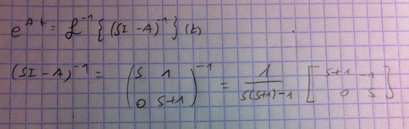

I have the following matrix:
A=[0 -1; 0 -1]
and i need to calculate: exp(At) in several ways, 2 of them are using the reverse Laplace transform and using: I + Ʃ(A^kt^k)/k!
i have tried to start the series but i am getting an expression that i can't say which series it is,
and when i try with Laplace i get the one of the matrix expressions is a step function..
i will apreaciate the help...
thanks!
What are you getting for
[tex](sI-A)^{-1}[/tex]
this is what i get. but i can't find the reverse transform...
You are dividing by the wrong thing. Divide by
[tex]s(s+1)[/tex]
instead of
[tex]s(s+1)-1[/tex]
but
[tex]s(s+1)-1[/tex]
is the deteminante..
in oreder to reverse 2*2 matrix i do this:
[a b ; c d]^-1 = [d -b; -c a] * 1/det
no?
erezb84 said:
but
[tex]s(s+1)-1[/tex]
In oreder to reverse 2*2 matrix i do this:
no?
1*0 = 0
daaaam! right, thanks!
