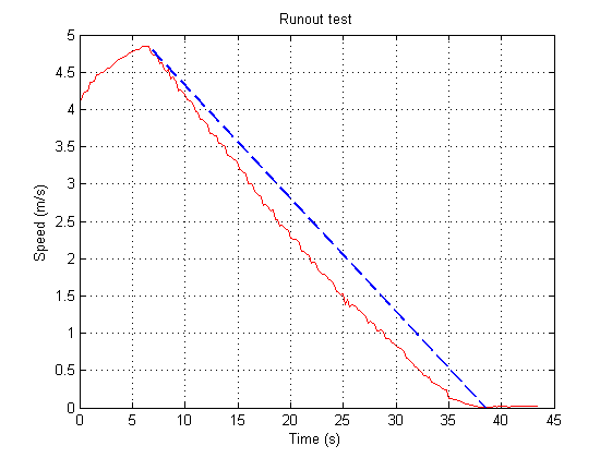

We've gathered data of the deacceleration of the car (doing a runout test) using GPS data. This means that we have the speed as a function of time. However, no matter what we do, it seems that we get the calculations wrong, as we expect the rolling resistance coefficient to be somewhere between 0.010 - 0.020 and the air drag might be 0.3 - 0.9.
Here is a graph of the speed as a function of time.
http://dl.dropbox.com/u/202411/p2/runout1.png
The graph is generated with MATLAB using this data: http://dl.dropbox.com/u/202411/p2/v.txt , notice that this is just the speed, however, we sample 5hz, which means Δt = 0.2s between each datapoint.
So, how do we calculate the correct airdrag- and rolling resistance coefficient, preferably with the lowest possible error?

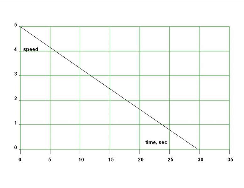

Here is a plot of your car deceleration using a Crr of 0.017. There is no curvature. If I add air drag, I see no effect until the drag coefficient is over 1. Stokes (linear) air drag may apply at these speeds. How level is your track? A change in slope of 0.1% makes a difference.
I can't deny that there might be a slope of 0.1%, but it should be more or less as level as it can be... So you might recommend us doing calculations at higher speeds?
Yes, if you just use Crr there won't be any curvature. Can you tell me how you made the calculations/graphs using both rolling and air resistance, and tried changing the drag coefficient?

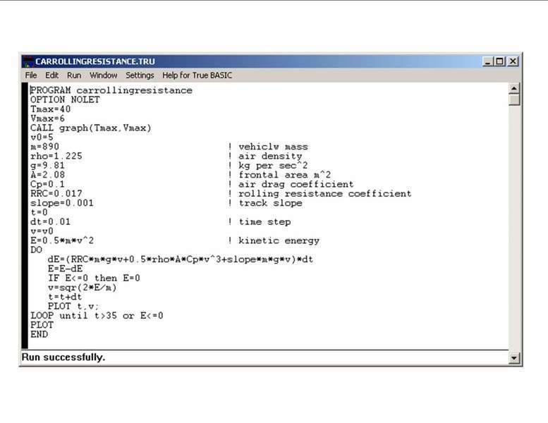

I used The program shown in the attachment (written in True Basic). A slope of 0.1% (1.2 inches per 100 feet) in your track is equivalent to changing your Crr by 0.001 ( i.e., from 0.016 to 0.017. You might run the test in the opposite direction, or using a different section of track. Higher speeds will make the turbulent air drag larger, and use a larger section of track, but running test in both directions will decrease the dependence on slope.

OK, Thanks for the help everybody. Just to close this topic, here's what we did. (I hate when there are no ending answers when looking around internet forums, so here we go :D)
Here is an example of data we gathered using GPS (something similar is already presented in the topic).
We quit trying to solve the differential equation that we started out with, and solved it using average change in deacceleration during the time.
[itex]C_d = \frac{m \cdot \frac{\Delta v}{\Delta t} - m \cdot g \cdot {\mu}_{rr}}{\frac{1}{2} \cdot \rho \cdot A \cdot (\frac{\Delta v}{\Delta t})^2 \cdot \Delta t^2}[/itex]
This gave us some possible values, here's an example, using data from the image i posted above.
[itex]C_d = \frac{890kg \cdot \frac{ 4,85 m/s - 0 m/s}{ 38,5s - 6,5 s} - 890kg \cdot 9,82 m/s^2 \cdot 0,014}{\frac{1}{2} \cdot 1.293 kg/m^3 \cdot 2,08 m^2 \cdot (\frac{4,85 m/s - 0 m/s}{38,5s - 6,5s})^2 \cdot (38,5s - 6,5s)^2} = 0,3962[/itex]
To prove that this was right, I created a program in MATLAB which calculates the run with different drag coefficients, rolling resistances and slope of the road. (This is done by making a for loop calculating the deacceleration, calculating the new speed ... and so on until you hit 0m/s) .. Playing around with different values proved that the calculated values were possible with a slope of 0.1 % (0.1 meter rise over a distance of 100m, and we can't really neglect this being a possibility)... Also, airforce and windspeeds (with or against the car) were not measured either, so these could have influence.
