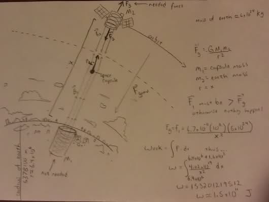

May5-12, 12:14 AM   #4
Magnet question
I had a nice 2 page write-up where I did all the math proving that this wouldn't be effective at all, comparing the energy uses to that of the shuttle et al. Also considering various outfits for M2 the satellite electromagnet, but when I submitted it, PF asked me to "please log in" and lost the whole post. So here is a little diagram that was part of it showing the work required to lift an object, provided you have a 100% efficient conversion through the different "types" of energy (which you never do). I do have a few of the final numbers written down, one of which was for the orbiting satellite to simply power the magnet (100% efficiency) it would require a solar array of 8 square miles, at 10-15% efficiency per cell.
What a bummer, I was proud of that post, and spent the better part of an hour writing it.

You cannot extract 'work' from a permanent magnet. It is a static field. You can temporarily get 'work' from a static field, like gravity, but, it is strictly temporary without an external energy source.
