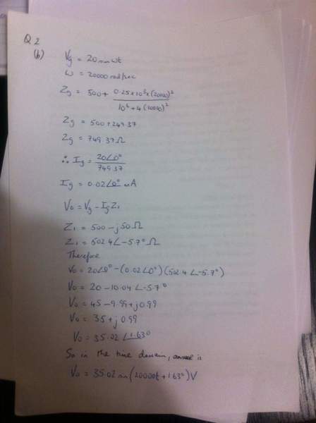

The frequency, ω, of the source in the circuit of Figure 2 is adjusted until ig is in phase with vg.
(a)using complex notation, determine the value of ω (rad/sec)
(b)if vg = 20 sin ω t [where ω is the frequency found in 2(a)], determine an expression for the output voltage, v0
See attached attempt on Question A & B - can someone advise if it looks right?

I think your frequency ended up being one order of magnitude too high. Check your math.
Thanks gneill.
Ah so where I have 10 to the power of 8, it should be to the power of 6?
hockeynut said:
Thanks gneill.
Well, you've got both 106 and 108 in the relevant area of your work, so you really should be more specific. But yes, that is the issue.
