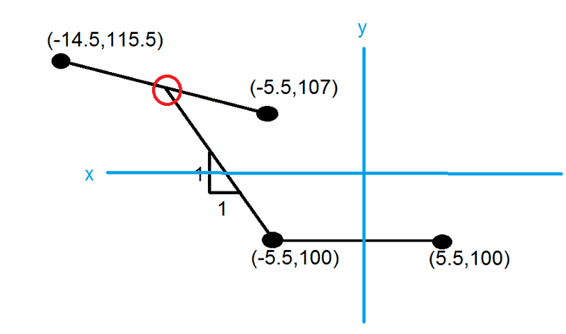

Kindly view my 1st attachment. I need help to get the intersection of the highest line and the line extended by a slope from the horizontal line.
y=mx+b
y-y1=m(x-x1)
Kindly view my 2nd attachment.
By substitution, I always get the answer -1.87 which is obviously wrong. The answer should be lesser than -5.5.
Thanks in advance.

The first equation (y = x+105.5) is not quite correct. The gradient does have a magnitude of 1, however the line slopes downwards along the x-axis, therefore the gradient should be -1, not +1 as you have used. See if that fixes the problem.
thanks, i'll work on it
