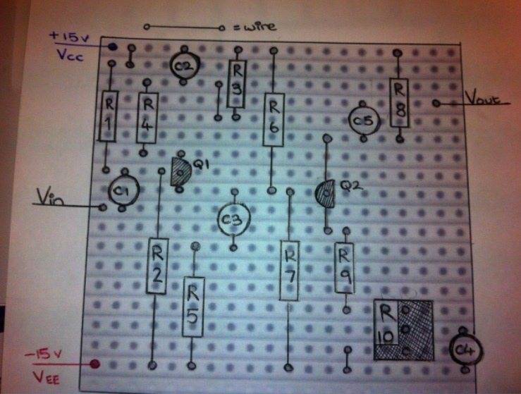

I have to build an audio pre-amp for an important test next week.
Attached is the circuit schematic and deliverables wanted.
I would appreciate anyone who could draw out the actual component placements
on the attached stripboard print.
R10 is a variable resistor in particular the placement of this component i find difficult.
Thank you

Your pdf indicates that the straight line which is part of the two-line icon for, "capacitor," corresponds with its positive leg (provided that we are dealing with polarized caps). This leg should be made to connect with what is known as the "wiper" of your variable resistor (or, potentiometer, or, attenuator, etc...). That arrow pointing at the center of the resistor (zig-zag) icon is normally meant to symbolize (the wiper of) a variable resistor (not "varistor"), or pot, in America I had thought (confirmed by Wackypackia, here:
(imagine link - need 10 posts or a bag of spells for this power))
. I should imagine that this is how variable amounts of gain are obtained from the preamp.

I see what seems to be a major problem with the preamp circuit. The block diagram shows only a single connection between the microphone and the preamp. However the microphone really has two connections, signal and ground. The preamp circuit has no ground. To where are you to connect the microphone ground? There are solutions of course, but I suspect you are not allowed to change the circuit.
Before computers, the way I laid out circuit boards was to take quadruled paper (graph paper) and draw the pads of the components as seen from above leaving a lot of space between components. I would draw the connections between pads on one side of the board with red pencil and the traces on the other side of the board with a blue pencil. In subsequent passes, I shrank the space between the components and sometimes rearrange them to make the layout tighter.

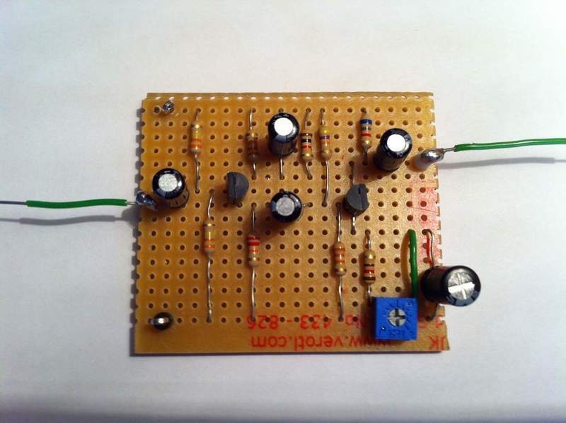

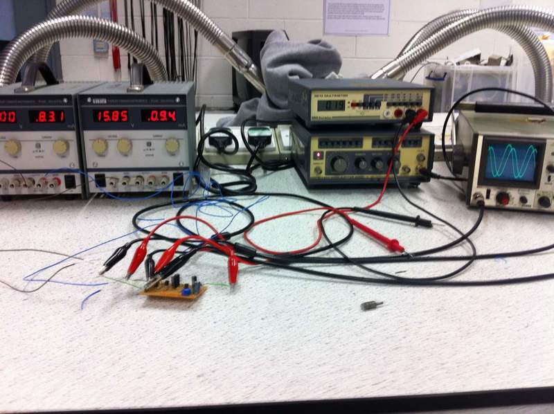

Thank you very much for the help very much appreciated...I will look into everything again today and get back to you if that's ok with you? I believe the microphone diagram you are talking about is only a pictured example of the function of preamp but does not correspond to the actual schematic given.
In regards to the test my actual test is to get this circuit working and as you can see show gain and phase shift to my lecturer using signal generator,power supply,oscilliscope etc..
I am going to look into it more.I do have a photograph of this circuit that i had original built a few months ago yet did not work hopefully more light could be shed.
Thank you very much for your help so far and your quick reply.

Also the picture of my original pre amp some months back.

A good way to troubleshoot your circuit is to program your circuit into SPICE and compare voltages at the nodes between what SPICE calculates and what you measure. If you don't know SPICE, I strongly suggest you learn it.

I have re-drawn the circuit onto the actual size of stripboard I will be using,The middle pin of R10 is the 'wiper'.
I would appreciate any feedback on this and if mistakes have been made.
The drawing is attached.
Thank you
