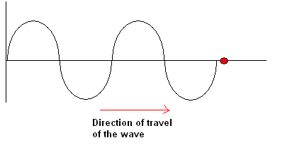

OK one more little visualisation for you :)
look at the wave in this pic...
assume the horizontal line is the level surface of the pond water.
and the red dot is a cork sitting on the surface of the water
now in your mind move the wave in the direction shown, what is going to happen to the red
dot as the wave encounters it ? visualise how the red dot is first going to move down to the lowest part of the wave ( the bottom of the cycle) then come back up and through what was the flat surface level then its going to continue up to the wave peak and then start coming back down again. and continue doing that until there are no more waves passing by.
NOTE !
1) this is a traverse wave, the particle motion is perpendicular to the direction of travel of the wave
2) that the red dot doesn't move foreward along with the wave. it ONLY "bobs" up and down as the wave passes by
cheers
Dave

davenn said:
the wave has completed (ended) for a given particle when it is no longer oscillating... ie. it has returned to its rest state.
um I don't get you ... ( if we are referring to water in a pond, as the ripples (waves) spread out from the point of origin, they pass by the "particles " of water and those particles rise up and down about their rest position -- the normal level surface of the water)
