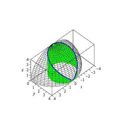

Find the surface area of the portion of the cylinder [itex]x^2+y^2=4y[/itex] lying inside the sphere [itex]x^2+y^2+z^2=16[/itex]
Double integral for finding surface area.
[itex]\iint_S d\sigma[/itex]
At first, i thought it was just the area of the surface of sphere found inside the cylinder which goes up and down infinitely and is parallel to the z axis. But then it occurred to me that it was about finding the lateral surface area of the cylinder, which is a tad more complicated.
See attached graph for cylinder projection on the x-y plane. The sphere has a radius of 4, so it completely encloses the cylinder in the x-y plane, until the latter shoots through the sphere.
Here is my plan to find the lateral area of the cylinder: split the cylinder in half across y-z plane and then project one half on the y-z plane and then finally multiply the answer by 2 to get the whole surface area.
But if i substitute the equation of the cylinder into the equation of the sphere, i get [itex]4y+z^2=16[/itex] which gives me the equation of points of intersection at the surface between the sphere and cylinder. See second attached graph. I can use that equation to find the limits later on.
So, considering the equation of the cylinder directly. Since i will be projecting onto the y-z plane: [itex]x=\sqrt{4y-y^2}[/itex]. Then, i find ##x_y## and ##x_z## and the usual steps to finding the surface area gives:
[tex]\iint_Ω \frac{2}{\sqrt{4y-y^2}}\,.dydz[/tex]
[tex]\int^{z=4}_{z=-4} \int^{y=\frac{16-z^2}{4}}_{y=0} \frac{2}{\sqrt{4y-y^2}}\,.dydz[/tex]
I'm stuck with the integral.
I tried with polar coordinates but it just gets more complicated. Any advice?

That is an interesting, but not easy, problem. I would parameterize it in cylindrical coordinates to begin with. The first thing to show is that the equation of the cylinder in cylindrical coordinates is ##r = 4\sin\theta## for ##0 \le \theta \le \pi##. (You can do that, right?) So parameterizing the cylinder gives$$
\vec R(\theta,z)=\langle r\cos\theta, r\sin\theta,z\rangle=\langle 4\sin\theta\cos\theta,4\sin^2\theta,z\rangle$$Now, as you have noticed, it is tricky figuring out the ##z## limits, which will depend on ##\theta##. The sphere in cylindrical coordinates is ##r^2+z^2=16##, so put ##r=4\sin\theta## in that to get the relation between ##z## and ##\theta## on the intersection curve. You should get ##z=\sqrt{16-16\sin^2\theta }= 4|\cos\theta|##.
You now have the parameterization and the limits. Do you know how to figure out dS and set up the integral from here?

My understanding for finding the surface area is more directly related to what Karamata has posted.
But the method you have suggested using [itex]dS = |\vec R_\theta \times \vec R_z|\, dzd\theta[/itex] is that the only way to solve this particular problem? Or can it be solved using what i already know? Just asking.
I'll pick up some books in the library tomorrow and will investigate more on your suggestion.
OK, i managed to work it out, but using a somewhat different method that was hard to find, as it was only a small paragraph in my notes.
The lateral surface area of cylinder is obtained from the line integral:
[tex]\int_C (z_2-z_1)\,.ds[/tex] where C is the equation of the circle which forms the base of the cylinder in the x-y plane and ##z_2## is the upper surface and ##z_1## is the lower surface of the cylinder.
Using the same parametrized equations derived in the posts above; [itex]r=4\sin \theta[/itex] and ##z=4\cos \theta##
[tex]\frac{dx}{d\theta}=4\cos 2\theta,\;\frac{dy}{d\theta}=4\sin 2\theta[/tex]
[tex]z_1=0,\;z_2=4\cos \theta[/tex]
[tex]ds=\sqrt{ \left( \frac{dx}{d\theta}\right)^2 + \left( \frac{dy}{d\theta}\right)^2}\,.d\theta=4d\theta[/tex]
So, the line integral becomes:
[tex]\int^{\pi /2}_0 4\cos \theta \,.4d\theta=16[/tex]
To get the whole surface area, i multiply by 4, and the answer is 64.

I learned your suggestion. I realize that i had previously only done explicit formula for surface area. This problem relates to parametrization of surface area, which i just read about, and there is a third formula which deals with implicit surface area, which i have not done, and probably not included in my syllabus.
[tex]\vec R(\theta,z)=\langle r\cos\theta, r\sin\theta,z\rangle=\langle 4\sin\theta\cos\theta,4\sin^2\theta,z\rangle<br /> \\\vec R(\theta,z)= 4\sin\theta\cos\theta\hat i+4\sin^2\theta\hat j+z\hat k=2\sin 2\theta\hat i+4\sin^2\theta\hat j+z\hat k<br /> \\\vec R_\theta=4\cos 2\theta\hat i+8\sin\theta\cos\theta\hat j=4\cos 2\theta\hat i+4\sin 2\theta\hat j<br /> \\\vec R_z=\hat k<br /> \\\vec R_\theta \times \vec R_z=\begin{vmatrix}\hat i & \hat j & \hat k \\ 4\cos 2\theta & 4\sin 2\theta & 0 \\ 0 & 0 & 1\end{vmatrix}=(4\sin 2\theta)\hat i - (4\cos 2\theta)\hat j+0 \hat k<br /> \\|\vec R_\theta \times \vec R_z|=\sqrt{(4\sin 2\theta)^2 + (4\cos 2\theta)^2}=4<br /> \\dS = |\vec R_\theta \times \vec R_z|\, dzd\theta=4\,dzd\theta<br /> \\\int_0^\pi \int_0^{4|\cos\theta|}4\,dzd\theta=0[/tex]I don't understand how you got the area of 32.
But if i split the region above the plane z = 0 in half across the plane y = 0, then the limits become ##0\le \theta \le \pi /2 ## and the double integral becomes:
[tex]2\int_0^{\pi /2} \int_0^{4|\cos\theta|}4\,dzd\theta=32[/tex]
The method that I've used in the above post #13 is actually part of my notes, but in the sole given example, it relates to a cylinder with its vertical axis as the z axis and bounded between 2 planes ##z_2## and ##z_1##, but this problem here is different in 2 ways:
1. This cylinder's axis is not the z axis.
2. This cylinder is bounded between a smooth surface and a plane.
Although i struggled for a long time and repeatedly to understand what i might be doing wrong, i think the line integral formula that i used is limited as it might only relate to cylinders which are bounded between planes, and not surfaces. Or maybe the line integral formula doesn't work either if the cylinder's axis is not the z axis, but the latter isn't convincing.
To conclude, i think that the line integral formula for calculating the lateral surface area of cylinder, relates only to planes, just like the Green's theorem, hence why the formula in my notes didn't work on this problem. Do you happen to know anything about that line integral method?
On a side note, how did you plot that graph? What software did you use? I tried using various graph plotters, like wolfram, etc, but couldn't get the same result.

Hello Sharks. I haven't been purposely ignoring you. Real life intervened and I spent several days in the hospital for the first time in my life. Anyway, to answer your question, I plotted that picture with Maple.
