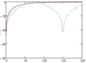

You are missing your sampling frequency in your bilinear transform. It should be: s=150(z-1)/(z+1).
By the way with such a low sample freq compared to corner frequency (150Hz and 50Hz respectively) this will be a very bad discrete time realization of your first order filter (see attached image, red is ideal first order, blue is your discrete time realization, vertical is dB).
Does this help?
