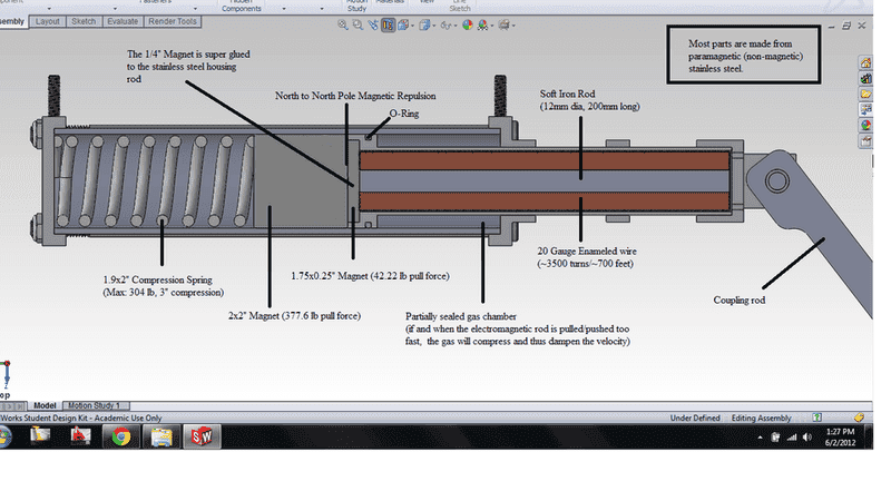

Does anyone know how to calculate the attraction strength of a permanent magnet to soft iron rod?
http://www.kjmagnetics.com/proddetai...prod=DY0Y0-N52
This is the permanent magnet.
The cross sectional diameter of the iron rod is 12mm, separated by a distance at 1/4" and 1/2". Both are restricted on an axis. Will changing the diameter of the iron rod change the attraction strength?
Is there an equation for this?
*I attached an image of my current setup.
The cross sectional diameter of the iroin rod is 12mm, separated by a distance at 1/4" and 1/2". Both are restricted on an axis. Will changing the diameter of the iron rod change the attraction strength?
It would be hard to do better than using the calculator on the link. The force will be very dependent on actual spacing.
