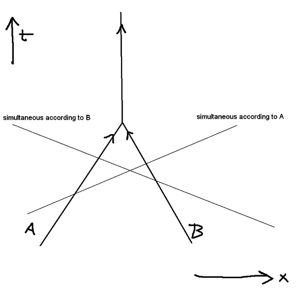

I am referring to a diagram where each observer sees something different as simultaneous. Forgot to attach it, will do now.
No, nobody can post a detailed analysis to this problem because haven't provided enough details in the problem. Please fill in all the details that you have in your mind and then we can give you an analysis.
Again, I am sorry for being unclear. I hope I made it clearer now.

They do not see different things when they look at the same clock, when they are both next to the clock. They see the same time indicated on the clock. If one observer is next to the clock and stationary and the other is next to the same clock but moving, the moving observer will see the same clock ticking slower. Please be aware that the time indicated on a clock and the ticking rate of a clock are two different things.
P.S> Thanks for posting a diagram. That will help everyone a lot. Unfortunately I do not have time to go into it right now.

I'm talking about an unsymmetrical situation, yes. When both observers look at the stopped clocks(as you have said, where both stopped clocks show different times to each observer) after reaching a stationary state. Is such a situation even possible?
Added another diagram to try and describe my experiment.

You say that it's unsymmetrical but your diagram looks symmetrical to me. Everything in frame 1 for Observer A is the same as in frame 2 for Observer B. Where's the asymmetry?
As an old thought experiment contructor I would suggest that first two clocks are next to each other, and they are put to the same time. Then one or both clocks are SLOWLY moved where ever we want them to be.
Then at some specific time both clocks are put to time zero, and one or both clocks are shot at high speed into some direction.
Both clocks will agree that both clocks were shot at time zero.
This is an analysis based on your sketch in #9, which shows the paths of clocks A and B as seen in the reference frame of a neutral observer that I will call C. Let's assume in C's reference frame both A and B start their stop watches t=0 and A is at x=-1 light seconds and B is at x = +1 light seconds. A has a velocity of +0.5c and B has a velocity of -0.5c as measured in frame C and they are heading towards each other. In frame C they pass each other at t = 2 seconds. According to observer C, the stop watches of A and B will both show 1.732 seconds at the passing event when they both stop their watches. It is irrelevant to the results whether A and B actually stop instantaneously when they meet or continue with constant velocity. Using the relativistic velocity addition equation we can work out that A sees B coming towards him at -0.8c and B sees A coming towards him at +0.8c.
Using the Lorentz transformations we can work out what observers A and B see in their rest frames. See http://hyperphysics.phy-astr.gsu.edu/hbase/relativ/ltrans.html
I am a bit short of time right now, so I will continue this a bit later, but this should give some solid initial conditions to start with.

yuiop said:
This is an analysis based on your sketch in #9, which shows the paths of clocks A and B as seen in the reference frame of a neutral observer that I will call C. Let's assume in C's reference frame both A and B start their stop watches t=0 and A is at x=-1 light seconds and B is at x = +1 light seconds. A has a velocity of +0.5c and B has a velocity of -0.5c as measured in frame C and they are heading towards each other. In frame C they pass each other at t = 2 seconds. According to observer C, the stop watches of A and B will both show 0.866 seconds at the passing event when they both stop their watches. It is irrelevant to the results whether A and B actually stop instantaneously when they meet or continue with constant velocity. Using the relativistic velocity addition equation we can work out that A sees B coming towards him at -0.8c and B sees A coming towards him at +0.8c.

yuiop said:

OK, I will give you a while to attempt your own analysis before I post mine.
OK, I tried analyzing and I got that observer A will see 1.25 seconds on his own clock and 0.75 seconds on B's clock, and that B will see 1.25 on his own clock and 0.75 on A's. C will see 1.73 seconds on A and B's clocks. Am I correct? These results are a bit confusing...
I figured the asymmetry is in the third situation(2 final frames).
What I said was that Observer A in frame 1 is symmetrical to Observer B in frame 2. You have described two different scenarios. In neither frame (and in neither scenario) will Observer A and B experience the same thing because in frame 1, Observer A is inertial and Observer B decelerates when they meet whereas in frame 2, Observer A decelerates when they meet while Observer B remains inertial all the time. Therefore, Observer A and B are not symmetrical in either frame (or in either scenario). So it's not surprising that your analysis shows that different things happen to them.
If you want to see a symmetrical scenario, you should describe both observers as approaching each other in a frame in which their speeds and clock settings are equal and then when they meet, they both decelerate equally so that they are at rest. You can then use the Lorentz transform to see what this would look like in Observer A's initial rest frame (which will not be symmetrical anymore) or in Observer B's initial rest frame (also not symmetrical), yet when they meet, their clocks will be synchronized. So you would have three different frames with different coordinates but all describing the same scenario.
You appear to be missing the simultaneity issue and also you seem to using the time dilation equations rather than the full Lorentz transforms.
I will continue with the analysis that I sketched the initial conditions for. I will just add a further point of reference of two space stations where A and B start their stop clocks and these stations remain stationary with respect to observer C.
In the reference frame (S') of A:
Rocket B passes station B at t1' = -1.155 seconds.
Rocket B passes rocket A at t2' = 1.732 seconds.
The time that passes in A's frame between those two events is 2.887 seconds.
According to A, rocket B is moving at 0.8c so the time dilation factor is 0.6 and the proper time that elapses on B's stop watch is 1.732 seconds. According to A, both A's stop watch and B's stop watch both show 1.732 seconds when rocket B passes rocket A.
In the reference frame (S'') of B:
Rocket A passes station A at t1'' = -1.155 seconds.
Rocket A passes rocket B at t2'' = 1.732 seconds.
The time that passes in B's frame between those two events is 2.887 seconds.
According to B, rocket A is moving at 0.8c so the time dilation factor is 0.6 and the proper time that elapses on A's stop watch is 1.732 seconds. According to B, both B's stop watch and A's stop watch both show 1.732 seconds when rocket A passes rocket B.
As you can see, the situation is totally symmetrical.
All clear now. Thanks.
