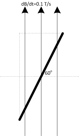

A closed loop of wire 7.2 x10[itex]^{}-3[/itex] m[itex]^{}2[/itex] is placed so that it is at an angle of 60degrees to a uniform magnetic field. The flux density is changing at 0.1 T/s.
The emf, in V, induced in the loop of wire is
A) 3.6x10[itex]^{}-4[/itex]
b)3.6x10[itex]^{}-2[/itex]
6.9
emf = NBA/t F=BiL
Area x 0.1 x sin60

What do you get if you calculate Area x 0.1 x sin60?
Btw, your formula emf = NBA/t is not quite correct.
It should be:
$$emf = -N {d(BA) \over dt}$$
where BA is the product of B and the projection of the area that is perpendicular to B.

Yes, it has to do with sin60.
Your problem states "at an angle of 60degrees to a uniform magnetic field".
How do you know it has to be the sine and not the cosine?
Or perhaps you should use the sine of 30?
Oh! You're right! I assumed it was sin60 because of F=BILsinx
Can you please explain to me how it works with sin30 instead?
Thank you! :)
Well, let's draw a picture:
The closed loop is the fat line.
It is placed so that it is at an angle of 60degrees to a uniform magnetic field.
Now what is the fraction of the fat line that is perpendicular to the magnetic field?

Would you use trig to find the perpendicular component?
Yes.
Do you know how the sine of an angle is defined?
sinx = O/H
But then do you have to find the diameter of the loop to act as the hypotenuse?
All correct. :)
Let's assume for now that you know the diameter of the closed loop.
So if you look at the triangle in the drawing, can you find the length of the short edge of the triangle?
Yes, would you do diameter x cos60?
Exactly!
Note that cos60=sin30=1/2.

I tried doing it again but so far all my triangles still tell me to do sin60... and using the diameter of the circle didnt work
If you look at the big triangle in the drawing, its sharpest angle is 30 and the other angle is 60.
The sine of the sharp angle (30 degrees) is the short edge divided by the diameter of the loop...
Which triangles are you looking at?
I tried to draw my own
Aha!
You selected another angle to be 60 degrees.
I have to admit that it is a bit ambiguous which angle should be 60 degrees exactly.
In my interpretation they started with the closed loop perpendicular to the magnetic field.
And then they turned the loop 60 degrees.
That way you get the picture I drew.In your picture you apparently started with the loop parallel to the field, and then started turning.
I'm guessing that this is not what they intended.
