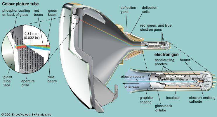

searched hi and low for some decent drawings of a CRT system, seems to be severely lacking
the best one was this one ...
cheers
Dave

Well you did better than me :) I also had a look for a schematic of the regular teaching setup ... which is simpler. Also, considering the topic, the diagram does not show an explicit return path for the electrons after interaction with the phosphor. That's something else that is lacking and makes the question quite intelligent.
