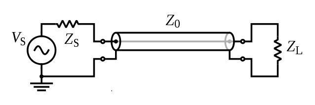

marcusl and haruspex,
In the attached figure, aren't the series resistances of the core and the shield added together to give the cable resistance? Sorry I understand that this is very simple question but I would like to know what I am not getting.
Thanks.
Ah - it was me that had the wrong set-up in mind. Yes, they're in series.
Thanks.
But this is a coaxial cable and not what is described in the OP.
The copper core is not "coated with layer of aluminum" but they are separated by insulator. The OP describes a two tightly attached coaxial cylinders.
You are right nasu. I got it wrong from the beginning. They are parallel then. Many thanks.
