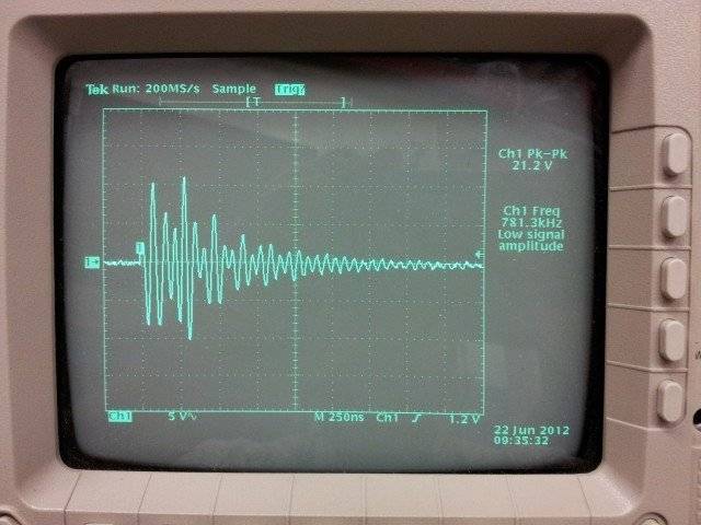

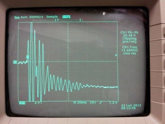

Thanks for the warm welcome. And thanks to smartphones...

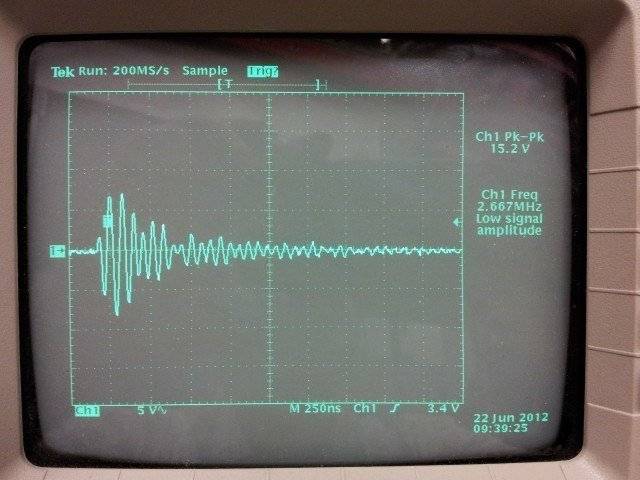

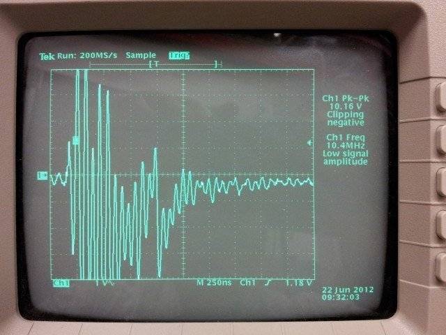

I was able to perform the tests you suggested and capture waveforms. Some background: this is in a 700 horsepower wind tunnel at a university. This giant 3-phase motor (run off a giant VFD) was running at the time I did the tests today. Presumably all the electrical wiring was done by professionals. It's typical here to see a strip of outlets on the wall where each outlet is a different circuit (but the wires are all running inside the same "box" parallel to each other).
The instrumentation wiring is questionable at times. I honestly wish I could rip all of it out and start over, but no one will pay me to do that.
What I did today was again with my 100-Ohm "test circuit" of just a resistor. It's on a solderless breadboard. I used power supply A (the switching one with a 5V regulator). To give you an idea; the 5V "DC" has a ripple of 500 mV or so. This ripple goes away pretty easily with a typical bypass capacitor type of topology.
I'm not using an oscilloscope probe; I'm using a BNC cable with clip leads on the end.
To generate the spikes today, I switched on one of these ready-from-the-box under-cabinet fluorescent fixtures. You get a spike for each flicker of the bulb. The spikes vary from instance to instance but most are as bad as you see here.
In the following tests I tried to keep the scale the same but towards the end I changed it to see just how bad it really gets. The scope channel was set to AC coupling. Time scale is always 250 ns/division; the frequency measurement is often off but you can go off the time scale.
Test 1: Across the resistor. This is the test I posted about yesterday.
Test 2: Probe shorted (both clips on same side of resistor). This seems to "clean up" the ringing.

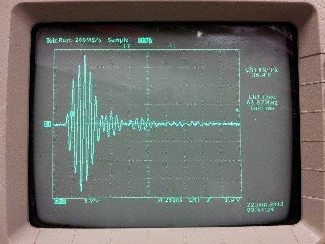

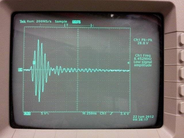

Then I plugged the oscilloscope into the outlet through an adapter from which I cut the ground leg off. So the oscilloscope is no longer connected to Earth ground.
Test 3/4: Scope ungrounded, first across the resistor and then probe shorted.

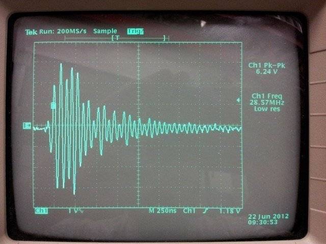

Then I disconnected the resistor from the DC supply and connected it to a single D-cell battery.
Test 5/6: Battery powered resistor circuit, scope ungrounded, first across resistor then probe shorted.

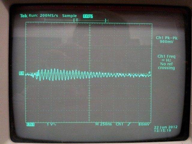

So from my point of view, the tests show the following:
1. The DC supply is affected by the phenomenon. There is a consistent difference between measurements across the resistor when powered by the DC supply and everything else.
2. The high frequency ringing seems to be traveling through the air since it happens with the probe shorted, with our without grounding the scope, and when the resistor is powered by a battery.
Unless it could be coming in through hot or neutral and affecting the scope?

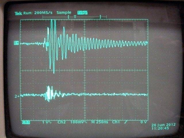

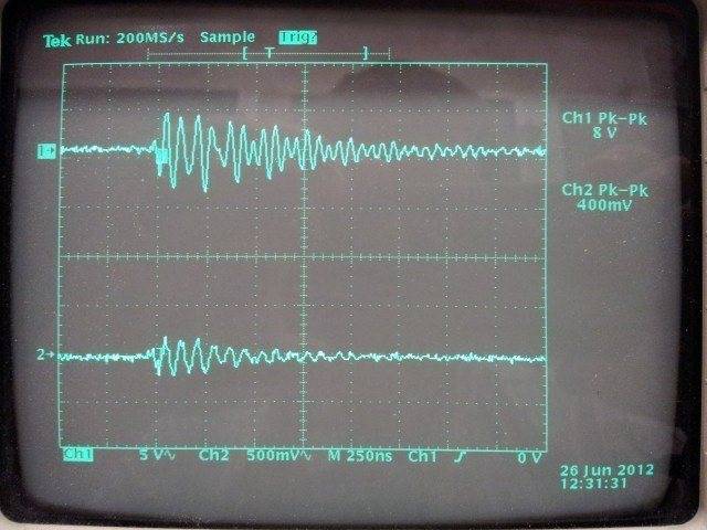

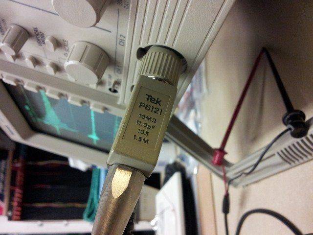

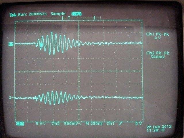

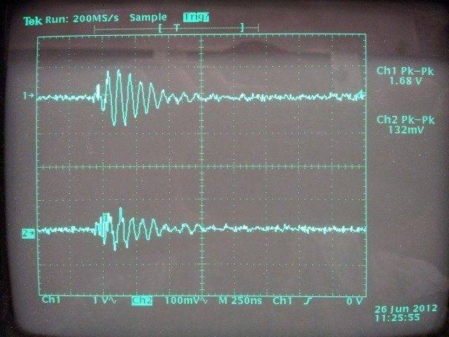

Here are some more tests that I did last week.
First, I compared an oscilloscope probe to the BNC cable I had. The probe certainly sees a very different thing---primarily, much lower voltage spikes. Here are the traces with the probes shorted. The TEK probe is on channel 2.
Here are the traces with the probe and cable connected across a resistor (both channels on the same resistor at the same time), the resistor unpowered.

Then I put a diode in front of the resistor, so current could only flow into it, but not "back into the supply". I would have expected to see an asymmetrically clipped ringing, but I don't:
So I think everything points to this problem being transmitted by air and not by the supply:
1. With the BNC shorted to itself, and the probe shorted to itself, there's a clear difference in the frequency of the waveform (the frequency on the shorted probe is much higher).
2. Once I start testing with the resistor, I'm now connecting the BNC cable to the oscilloscope probe, so the waveforms become the same, except for the decreased magnitude in the probe. The probe is 10X and even if I forgot to set the scope, the difference is not a factor of 10X so the change in magnitude is real.
3. If this ringing was coming in through the power supply wires, the diode should have clipped it, and it doesn't. So it must be coming in via the BNC cable. This also goes along with the fact that I could see it even when the resistor was powered by a battery and the oscilloscope was on a UPS battery (unplugged from the wall).
Of course if this is an EMI/RFI thing that can be fixed by proper shielding, then why is this room so bad? If this were happening all over the building it would be a well known problem because no one shield anything properly here. Is it possible that the amount of rebar in the wall, for example, can affect this?
The only AC switching that doesn't cause this are things like HP benchtop multimeters. Everything else does. So did I just get lucky that there's something in the electrical wiring of the room that's resonating? If so, it must be in the ground or neutral because every circuit behaves the same.
I will start by making sure the single ended driver of the encoder is properly shielded. I haven't tried an RC filter on the output and I cannot change the "trigger voltage" of the counter; the only thing I have an option of doing with the hardware (National Instruments acquisition card) is to apply a debouncing filter, but only at the highest setting (longest minimum pulse width) does it filter out the problem and at that point we can go below this minimum width during operation of the encoder (the encoder turns fast enough that the debounce ignores real pulses) so it's not a solution.
Can you draw a circuit of your test setup that includes grounds in the wall?
If I understand your posts correctly the scope shots are a differential voltage across a 100 ohm resistor. To get 0.4Vpp on the resistor over the air something has to be injecting 4mA into your circuit. I find this extremely unlikely.
I think it is much more likely a reference is moving somewhere due to a ground loop. But if the scope shots are differential then there would have to be some kind of non-zero common mode gain to see those shots which is also kind of odd but possible at a couple of MHz.
In short. I am pretty confused, as I suspect others are, and I think a high level schematic of the test setup would go a long way toward clarifying things.
This could also be a probing error.
For example, see figure 1-9, figure 6-5, and figure 6-10 in the publication below. These are various ways the probe ground can pick up noise in circuit. As the probe is AC coupled in the shots its hard to know which is applicable. Also notice in figure 6-10, the noise is transmitted over the air into the loop which includes the ground probe.
http://www.cbtricks.com/miscellaneous/tech_publications/scope/abcs_of_probes.pdf
that fig 6.5 is worth a thousand words.
I have been searching for words to express this thought -
Electricians sometimes get creative when wiring a room. If the line and neutral to an outlet get run physically apart from one another, that creates a loop. So long as they're run together in the same "romex" or same conduit the area of the loop is quite small, but if they're separated they make a loop antenna that 'broadcasts' in accordance with whatever current is running around it. At 60 hz not much energy goes into the air, but a small antenna works better at higher frequencies.
I don't know quite how to check for this without getting inside the walls...
but here's some thouhts -
a lamp dimmer is quite a noisy thing, electrically. A plain incandescent lamp from thrift store, powered through a lamp dimmer, will generate electrical noise. A cheap transistor radio set to AM band in between stations will give you an idea how much of that noise makes it into the air.
I'd try that lamp dimmer-radio test at several outlets around the troublesome room and again in one of the well behaved rooms.
If a striking difference jumps out at you, maybe that's a thought path to look into. If not you will have wasted an hour or two.
I used to wander around the power plant looking for fields with a loop , ten turns on 1/10 square meter area (14 inch diameter), connected to a battery powered scope. If your dimmer/radio finds something worth pursuing, that simple experiment would let you put a number on it.
you have my sympathy on this one, bro !
Figure 6.5 shows a simple ground loop: device under test plugged into a different outlet than the oscilloscope. This is definitely the case when I'm powering the test resistor from either power supply. However, it's obviously not the case when I'm just shorting the probe or powering the resistor from a battery.
The wiring in this room should be "decent". Everything I'm looking at is on the same wall as the electrical panel and the walls are massive concrete so everything is in conduits on the surface. The outlets where I'm plugging in the fluorescent light (or whatever I switch to generate the spike) are along a wall on one of these "modular outlet bars"---basically a steel channel where you can put outlets along it anywhere you want and fill in the rest with covers. I should be able to open this and see, but the standard practice here is to put two or three circuits into these channels and wire the outlets 1, 2, 3, 1, 2, 3, etc. So I doubt there is any funny business as far as neutrals going in physically different directions or, as it was the case at my house, a guy using the ground wire as a second neutral so he could put a switch for part of a circuit without running another "romex". But I should be able to check.
I know there are other places where the is funny business---we have a "home made" control panel, and about 1/4 of the status lights has a different neutral than the rest of the panel, and this neutral goes "through" another instrument (when I sent the instrument out for calibration that quarter of the panel didn't work and that's when I discovered it). Perhaps a worthwhile test, but I'm sure if I turn off everything in the room (including this cockamamy panel) I will still see this problem.
Looks like a good reference. Thanks.
I think the next thing for me to try is to carefully solder a twisted pair shielded cable to a BNC, short the two wires when it's connected to the scope, and see what I get.
I should probably look for another scope just to be safe...
