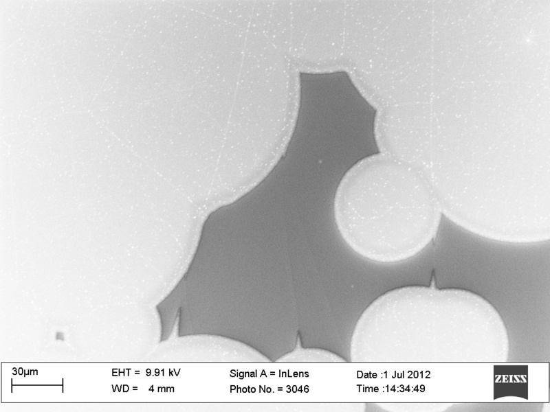

Microstructure of BST. What is the tail?
  • Thread starter Thread starter vinven7
The discussion focuses on the microstructure of Barium Strontium Titanate (BST) with over 2% borate added to enhance grain size. The SEM image presented reveals significant abnormal grain growth, with grain sizes reaching approximately 100 micrometers. Additionally, the presence of tails emanating from the grains raises questions about their origin, with suggestions that they may be related to preferential growth paths or surface scratches.

Attached is the SEM microstructure of Barium strontium Titanate (BST) to which has been added over 2% borate so as to increase the grain size. The image clearly shows abnormal grain growth and the grains are huge - around a 100 um. But also visible in the image are these tails that emanate from the grains. Does anyone have any guess as to what that is?

i may be wrong, but are the tails growing along scratches? could that be a preferential growth path?
that may be true. Thanks for the info.
