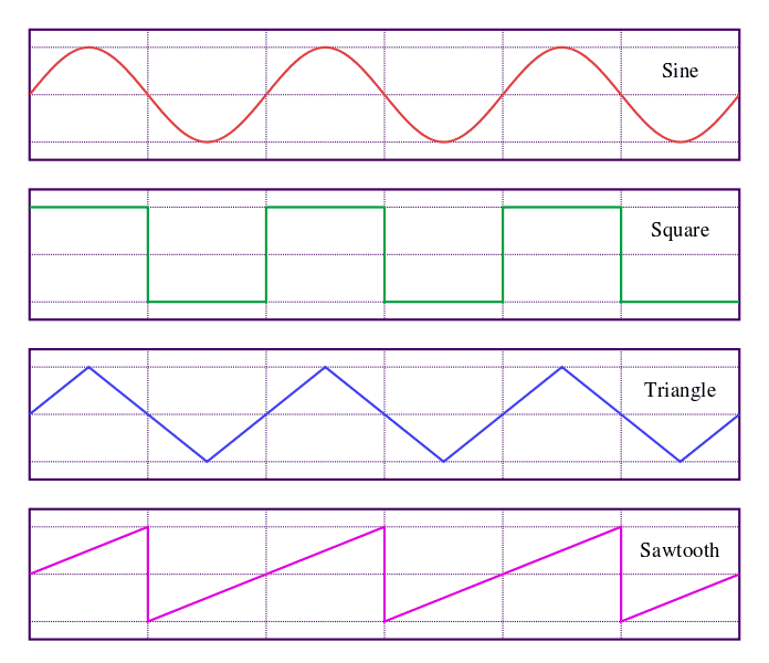

Jul7-12, 11:00 AM   #8
The understanding of square waves is that there are only discrete values with respect to time unlike the infinitely variable sawtooth, triangular and sinusoidal waveforms. Since inductors are used to convert electrical energy into electromagnetic fields and sending a fluctuating DC or AC current will cause the inductor to emit radiation, will square waves not just generate constant magnetic fields and not emit radiation that can be transmitted at a long distance and converted back to an electrical signal by the receiver? Because with a square wave, the power of the signal remains constant over a given period of time until the next component of the signal which can be a negative or 0 which will also remain constant for a given period of time. Does there not need to be a continuously fluctuating waveform electrical signal sent to the wireless transmitter for the transmitter to emit radiation?
Waveforms:
